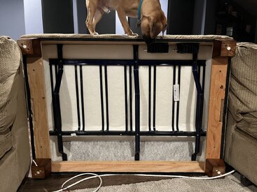

You might also try wiring them in parallel to lower the impedance and increase power output from the Sony if it can handle the lower impedance.
I'm thinking that the board is absorbing too much of the vibrations, and maybe mounting them directly to the frame would be better.

I haven’t even messed with the sub levels on the Sony yet. I’ve mounted them directly to the couch and wired them individually.
Much improved!
That piece of plywood I used definitely wasn’t helping anything. I wonder if each shaker getting more than enough power helped too. Now, to play with settings and get them dialed in!
