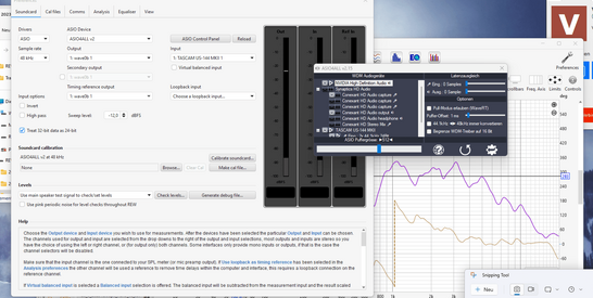

If the Java driver works, there's really no reason not to use it. But with ASIO4ALL, did you try increasing the ASIO Buffer Size in the ASIO Control Panel in REW Soundcard Preferences?
Alpi
Feb 21, 2018
72
You mean that?

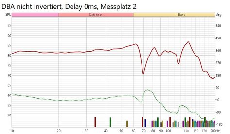

My DOUBLE BASS ARRAY
The delay of the first measurement of the left loudspeaker with the Java excl. I entered the driver at delay (-0.1044) at "timing / use acoustic timing reference". I made all of the following measurements with this timing reference. I would like to simulate my DBA based on the measurements with the "alignment tool". But this tool is so extensive and I would like to know how to use it to simulate the DoubleBassArray or a transition from the subwoofers to the loudspeaker - I would also like to understand it. Here are the front and rear array measurements.
With the classic DBA you invert the rear array, enter the room length as the delay and lower the gain of the rear array by 1 to 2db.
With my DBA I get a great frequency response and waterfall without inversion and without delay?
The classic DBA with inversion etc. also works, but the waterfall is not that nice and I need more DSP filters. How do I optimize the phase with the simulation or what tools does the simulation (alignment tool) provide me with to adjust or simulate the DBA in the best possible way?
Can anyone help me with the simulation?
