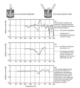

I suppose his reputation is based in part on observations like this one here, based on other people’s research that he discusses. In this example, he points out that when absorbing side wall reflections, comb filtering in stereo listening creates a null around 2khz.
However, when the side wall reflections are allowed to exist, those reflections add to the total sound hitting the listener in ways that can fill in the null. (Message people take away: Toole loves side wall reflections!)
Actually he is really using this data (not his studies but a half dozen other peoples work) to argue for using a center channel, which solves it and solves other things as well.
But it is also a good reminder how side wall absorption can hurt stereo listening.
