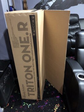

Ahh! The joys of purchasing from a local dealer! I purchased the Triton One.R’s from Stereo East in Frisco Texas and they were delivered on December 24th (Merry Christmas Little Tommy! :-). They were delivered on time and carried to my Media Room by two wonderful delivery folk and unpacked very carefully and set up as I directed. We ran some sound through them and I turned the guys loose with my thanks. I knew I had a few hours of tweaking, playing and breaking in to do before seriously listening to the speakers so I just allowed them to play at a fairly high volume while I went about doing some other things.

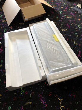

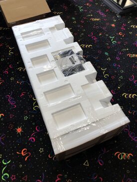

The speakers were each packed in large imposing carton of heavy cardboard inside of which was a three piece foam clamshell completely surrounding the speakers on all sides. A plastic bag and another layer of no-scratch, soft, closed cell foam wrapping material swaddled the speakers. Accessories such as the manuals, spikes and rubber feet were tucked into compartments top shell as pictured below.
My delivery guys had obviously done this routine more than a few times and carefully opened the box and folded back the cardboard to reveal the foam clamshell. I judged the packing to be very good and appropriate for the eighty pound speakers.

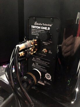

The back of the speaker contains a plate with a single set of banana/spade lug capable connections. There is also a volume control for the built-in 1600 watt sub-woofer amplifier and a bright blue LED power indicator. The sub-woofer amplifier is an auto-on device.
The speakers are NOT bi-wire/bi-amp capable for a reason. Sandy Gross, the lead designer of the speakers has stated his team put a lot of effort into the voicing and the design and construction of every component of the speaker and a lot of attention was given to the crossover. GoldenEar calls the crossover a “Perfect Phase Crossover” and would obviously like users to use the speaker as designed. My speaker cables were made with the idea of “bi-wiring/bi-amping” but work just fine as they have a set of spade lugs on one pair and locking banana plugs on the other wire pair connecting easily and securely to the three-way binding posts of the Triton One.R’s.

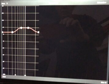

Luckily my friend Joe and his wife Charlene flew over from Nashville for a visit right after I had finished my break-in and initial setup of the speakers and before I had really started any serious listening.
I say luckily, because Joe is a professional soundman. He, his brother and I were partners in the first professional recording studio in Rockford Illinois in the mid-seventies. Joe had continued the studio for a few years after I had pulled out and grew it into a successful studio and branched it into a VERY successful sound reinforcement and equipment sales company that has continued until today. Recently retired, Joe continues to work in Church venues as a soundman and consultant. He has recorded and mixed hundreds of artists in the studio and mixed live sound for thousands, many top touring acts, during his 45+ years in the business… Joe knows sound!
He took a look and listen to my setup of the speakers and made a few suggestions that made all the difference. Joe understands intimately the manipulation of sound and the use of EQ.
  • He suggested a 6db to 8db shelving EQ boost between 70Hz and 120Hz for adding some definition to the mid- mid-low bass.
  • The second suggestion was to add another little 3db pop around 5kHz to add some “Air” to the high end
  • And the third was a 6db wide dip at 2.5KHz to 3.5KHz to smooth out a harshness he perceived in that range.
Every suggestion was right on and sound was instantly more balanced and listenable for music.
I judged the boost on the bass bordered on maybe a little too much for movie soundtracks but that was easily remedied by manually dialing it back by 3db. Meanwhile music listening was much enhanced.
Joe and I listened to several music selections and watched several movies during his visit.
Joe Went Home

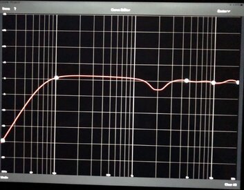

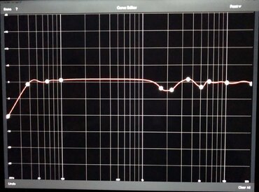

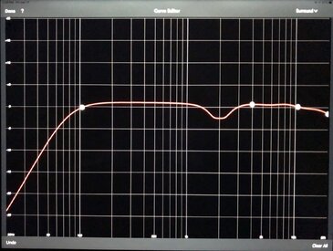

When he left I continued to tweak the sound using the Denon/Marantz Audyssey Curve Editor until it was just right for me.
For me that meant dropping the shelving bass boost on the low end slightly to around a 4db shelving boost and flattening the 5KHz bump just a little and moving the dip to center at 3.5KHz and flatten it to a 4db cut and adding a 3db rise at 3.5KHz for some additional air and finally restoring the high end roll off that the Audyssey wants to add and sent the changes to the Marantz.
Using the Denon/Marantz Audyssey Curve Editor App I dialed in my changes.
07-01182020-Front Curve adjust.jpg 08-01172020-Center Curve tweak.jpg 09-Subwoofer tweak.jpg 10-01172020-Surround curve tweak.jpg
Front Right and Left Tweaks Center Channel Tweaks Subwoofer Tweak Surround Tweak
I changed the Marantz BASS setting to “Main + Subwoofers” and dialed back the bass volume on the Triton One.R’s by about two hash marks.
