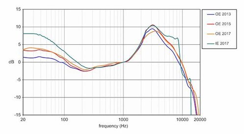

Hi everyone,
Good to find a good place to talk about calibration here.
I'm very interested in headphone calibration recently.
So does any one has a txt version of harman headphone target curve or a calibration file.
Thanks a lot!
foolion
Jun 8, 2017
5
7,406
The digitising software will probably have an easier time if you can find an image with just the target of interest, those curves are so close in places it may struggle to distinguish them and lose the trace it is trying to follow.

Hi Foolion,
here they are
  • Harman Kardon IE .txt
  • Harman Kardon OE.txt
Bernard
May 22, 2017
120
Thank you Bernard! I'm trying to use that now.
Hello
OE2013 curve : a trial with VituixCAD2.
Keep in mind that it isn't very precise.
  • FooLion_OE2013.txt
