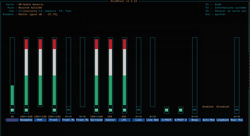

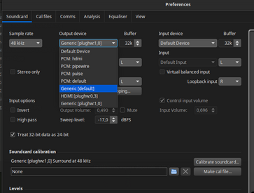

Finally, IIRC, REW reads alsaconfig as shown in alsamixer and there is no a52 device in there therefore no option in REW. In fact no alsa is working at all ion REW right now. Only PA/PW.
Capture d’écran du 2024-08-24 08-33-37.png Capture d’écran du 2024-08-24 08-33-02.png Capture d’écran du 2024-08-24 08-32-31.png

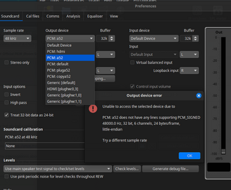

After several hours of tests and reboots, I wasn't able to get a52 to work without the plug wrapper. I did not see any working config either on the internet. All my tests failed. It's a plugin by default. It's included in alsa-plugins-a52.x86_64
If REW does use 'aplay -L' maybe a workaround would be to use a wrapper to append a52 to the actual 'aplay -L' output... However I would not know what precisely to add to achieve that.

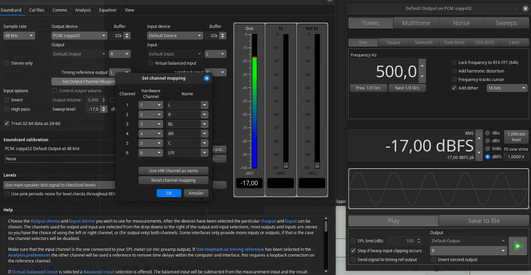

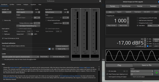

I did some tests with the a52 plugin. It does show up in REW. But it cannot be selected because it requires non-interleaved access format, while the alsa-PCM plugin of REW requires interleaved access only. Therefore it does not report any usable format in REW. When the a52 plugin is wrapped with plug or route plugins, they do the conversion interleaved -> non-interleaved access automatically and do report supported formats in REW.
snippet from my .asoundrc:
Code:
pcm.a52 {
        type a52
        slavepcm "iec958:{ AES0 0x06 AES1 0x82 AES2 0x00 AES3 0x00 CARD Generic DEV 0 }"
pcm.routea52 {
  type route
  slave {
    pcm "a52"
    channels 6
    ttable.0.0 1
    ttable.1.1 1
    ttable.2.2 1
    ttable.3.3 1
    ttable.4.4 1
    ttable.5.5 1
pcm.pluga52 {
  type plug
  slave {
    pcm "a52"
However, there is an issue I will sort out with John - REW tries to open the device at maximum channels it gets from the alsa-pcm adaptor (which is 10k for the plug plugin and 699k for the route plugin). Attached is a hacked .so library which limits the channels to 8. Just unzip the attached so file and rewrite the existing libcsjsound_amd64.so file in your REW installation dir with this file.
With this change REW seems to run OK. Unfortunately I have no AVR to check the generated AC3 through my SPDIF output.

Hi,
Thanks for your reply.
I agree with your explanation on IA hallucinating. I've experienced it most of the time.
Well, I replaced my entry with your snippet. All 3 work as expected with speaker test, however still nothing on the 'aplay -L output', therefore nothing in REW
Code:
10002  speaker-test -D plug:routea52 -c6 -t wav -l 2
10003  speaker-test -D plug:a52 -c6 -t wav -l 2
10004  speaker-test -D plug:pluga52 -c6 -t wav -l 2

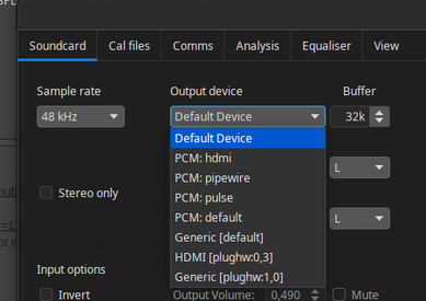

BTW, 1.2.2 looks pretty old. I run 1.2.8 (2022) on Debian 12 and Debian is not particularly known to have recent packages; On Fedora, I run 1.2.12 and none fo them display any a52 entry with 'aplay -L' although I'm pretty sure I remember seeing it in a previous version. In fact, I made the setup myself to add pcm.a52 and pcm.dca, but that was years ago.
And there is this link where it's mentioned twice that it is expected for a52 not to be listed by 'aplay -L' for 1.2.6 - https://bbs.archlinux.org/viewtopic.php?id=251467&p=4
UPDATE
Hardcoded everything as default. Now 'aplay -L' list them; REW doesn't see any though.
Code:
pcm.a52 {
    @args.0 CARD
    @args.1 SLAVE
    @args.2 RATE
    @args.3 BITRATE
    @args.4 CHANNELS
    @args.CARD {
        type string
        default 'Generic,DEV=0'

Yes they are listed. See my system after hardcoding:
Code:
$ !apl
aplay -L
null
    Discard all samples (playback) or generate zero samples (capture)
oss
    Open Sound System
pipewire
    PipeWire Sound Server
pulse
    PulseAudio Sound Server
a52
    Plugin to convert multichannel stream to A52 (AC3) bitstream
hdmi:CARD=HDMI,DEV=0
    HDA ATI HDMI, HDMI 0
    HDMI Audio Output
a52:CARD=HDMI
    HDA ATI HDMI
sysdefault:CARD=Generic
    HD-Audio Generic, ALC1150 Analog
    Default Audio Device
front:CARD=Generic,DEV=0
    Front output / input
surround21:CARD=Generic,DEV=0
    2.1 Surround output to Front and Subwoofer speakers
surround40:CARD=Generic,DEV=0
    4.0 Surround output to Front and Rear speakers
surround41:CARD=Generic,DEV=0
    4.1 Surround output to Front, Rear and Subwoofer speakers
surround50:CARD=Generic,DEV=0
    5.0 Surround output to Front, Center and Rear speakers
surround51:CARD=Generic,DEV=0
    5.1 Surround output to Front, Center, Rear and Subwoofer speakers
surround71:CARD=Generic,DEV=0
    7.1 Surround output to Front, Center, Side, Rear and Woofer speakers
iec958:CARD=Generic,DEV=0
    HD-Audio Generic, ALC1150 Digital
    IEC958 (S/PDIF) Digital Audio Output
a52:CARD=Generic
    HD-Audio Generic
Just clean all your added config into the general files, place those few lines into your .asoundrc, check with aplay -L (PCM-configured devices are listed at the beginning, before all the hints), restart REW, and you should see the added PCM devices.
Already did that multiple times changing one parameter at a time, which requires reboot every time. I don't have a clue how to restart alsa under Fedora. Nothing worked. Nothing at all. Working on that almost non stop for some 20 hours. My conclusion is that your system and mine are way too different. Best case: I can send sound to the plug:a52 device. Worst case: alsa not starting.
And still nothing listed in alplay -L in each and every test.

No they are not listed. I see only the a52 hints generated by the a52 alsa config files. If you copy this to /home/YOUR_USER/.asoundrc file (if not existing, just create it under your user):
Code:
pcm.a52 {
        type a52
pcm.pluga52 {
  type plug
  slave {
    pcm "a52"
You will see this:

# First time I get this working without a reboot!
$ speaker-test -D pluga52 -c6 -t wav -l 1

Results below. Not exactly what was expected.
Code:
speaker-test 1.2.12
Le périphérique de lecture est pluga52
Les paramètres du flux sont 48000Hz, S16_LE, 6 canaux
fichier(s) WAV
La fréquence est 48000Hz (demandée 48000Hz)
L'intervalle de la taille du tampon est de 1536 à 24576
L'intervalle de la taille de la période est de 768 à 768
Périodes = 4
était paramétré pour period_size = 768
était paramétré pour buffer_size = 3072
 0 - Front Left
 4 - Front Center
 1 - Front Right
 3 - Rear Right
 2 - Rear Left
 5 - LFE
Temps par période = 8,568384
$ cat .asoundrc
pcm.a52 {
        type a52

$ speaker-test -D copya52 -c6 -t wav -l 1
speaker-test 1.2.12
Le périphérique de lecture est copya52
fichier(s) WAV
Le format d'échantillonage est indisponible à la lecture : Argument invalide
Échec de la configuration des paramètres matériel : Argument invalide
$ aplay -v --dump-hw-params  -D copya52 /dev/zero
Lecture données brutes '/dev/zero' : Unsigned 8 bit, Fréquence 8000 Hz, Mono
Params HW pour le périphérique "copya52" :
ACCESS:  MMAP_INTERLEAVED MMAP_NONINTERLEAVED RW_INTERLEAVED RW_NONINTERLEAVED
FORMAT:  S32_LE
SUBFORMAT:  STD MSBITS_MAX MSBITS_20 MSBITS_24
SAMPLE_BITS: 32
FRAME_BITS: 192
CHANNELS: 6
RATE: 48000
PERIOD_TIME: 16000
PERIOD_SIZE: 768
PERIOD_BYTES: 18432
PERIODS: [2 32]
BUFFER_TIME: [32000 512000]
BUFFER_SIZE: [1536 24576]
BUFFER_BYTES: [36864 589824]
TICK_TIME: ALL
aplay: set_params:1387: Ce format d'échantillonage n'est pas disponible
Available formats:
- S32_LE
Actually the results are correct. Your a52 plugin is compiled with newer libavc and the plugin expects 32bit format S32_LE now, instead of S16_LE on my setup https://github.com/alsa-project/alsa-plugins/blob/master/a52/pcm_a52.c#L952-L956 . speaker-test supports only S16_LE - therefore the error. Generate a 32bit 6ch wav and it will play OK in aplay. Or you can use sox as a generator.

REW doesn't send output to the proper channels though. Could the tweak with the ',so' file be needed?
Capture d’écran du 2024-08-27 15-35-09.png Capture d’écran du 2024-08-27 15-38-19.png
Amazing, remapped channels and now it's working flawlessly. The anound of knowledge and/or research you made is amazing. Thank you so much for your patience and your time!

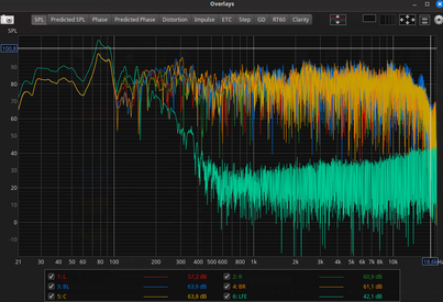

I've taken all my measurements!

Congrats, I am glad you made it work.
The REW's complaint about PCM:a52 not having any lines supporting ... is correct, because plain a52 plugin expects non-interleaved access, while the .so library in REW has hard-coded interleaved access https://github.com/pavhofman/csjsou...41525d770b39c4fe125c13321c08c/src/impl.c#L320 . The copy plugin wrapping a52 does the necessary conversion from interleaved to non-interleaved for REW.
Code:
$ LANG=C aplay -v --dump-hw-params  -D copya52 /mnt/linux486/tmp/output.wav
Playing WAVE '/mnt/linux486/tmp/output.wav' : Signed 32 bit Little Endian, Rate 48000 Hz, Channels 6
HW Params of device "copya52":
FORMAT:  S32_LE
Copy conversion PCM
Its setup is:
  stream       : PLAYBACK
  access       : RW_INTERLEAVED
  format       : S32_LE
Slave: A52 Output Plugin
Its setup is:
  stream       : PLAYBACK
  access       : MMAP_NONINTERLEAVED
  format       : S32_LE
Slave: Hardware PCM card 1 'HD-Audio Generic' device 1 subdevice 0
Its setup is:
  stream       : PLAYBACK
  format       : S16_LE
You can remove the unused pluga52 device config from your .asoundrc.
