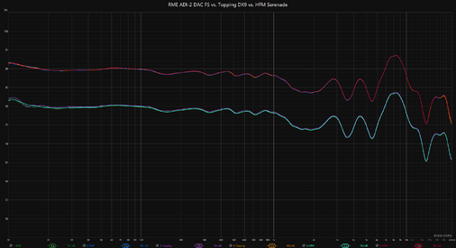

The frequency response is relatively flat across all three units within the audible range. At the extreme frequencies, the Serenade exhibited a 0.2 dB SPL deviation.
All three amps were level-matched to within 0.3 dB. The variation below 10Hz at 78 dB SPL is negligible, as sub-bass isn’t perceptible at that level. Deviations were minimal at 88 dB SPL, where sub-bass rumble becomes noticeable. I would expect to see some variations from round to round due to the slightly different placement of the headphones on the EARS rig. The Serenade lacks a volume level indicator, making precise level-matching frustrating. Every time the volume is changed, it must be manually recalibrated. This is why I appreciate a digital volume readout... it provides a consistent reference point.
For listening criteria, see Round One. I used the same reference tracks and methodology. And once again… I hear no differences. Not even the slightest. It’s remarkable how all three amps sound exactly the same. I hoped to pick up on some small difference, but there’s nothing there. Maybe I’ll have better luck in the next round.
