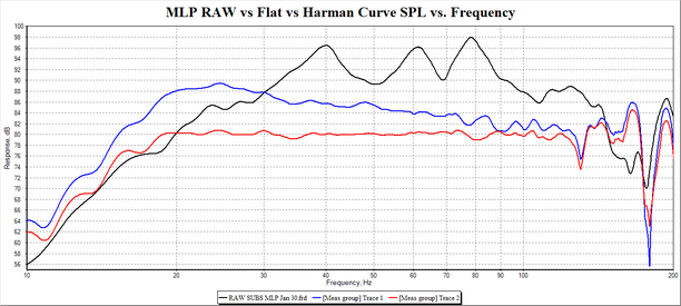

I added the raw measured response of the 4 subs to the graph. Now you can see before and after. See attached.

@welldun - I sympathize with you and go through similar frustrations. Indeed, they cause great doubt. o_OAnd I am not a beginner -- I've been playing with EQ for about 17 years now, with two automated systems and many manual ones, though I have no formal education in it.
I agree with @Sonnie and think it's an important point, measurement at < 500 Hz is not too tricky. The mics are not directional, sound is not very directional, and almost everyone likes smooth bass. BUT of course, you have to decide which dips are correctable (the shallower, wider ones) and which are not (the deep narrow ones). Then you must decide how much to boost the bass below, say 200 Hz, a boost usually needed for good tonal balance at home listening levels.
In the higher frequencies, one should avoid correcting dips caused by crossover diffraction, I'm told. Have fun figuring out where they are and, if you have an automatic system, how to get it not to correct them.
I consider 500 Hz to 2000 Hz a kind of transition zone. Above 2000 Hz, IME, all bets are off. Mics get more directional, and so do speakers. The precise mic and speaker position may influence measurements more than you expect. I've measured with two mics, both used the way they were intended, and gotten different results. One pointed straight up, the other between the speakers. Neither was supplied with a calibration curve for the other direction.
Then, what should you EQ? Time-windowed on-axis sound? Or pink noise with an RTA, which is averaged over time and includes more room sound? Most auto-EQ systems don't tell you what they do. I'm not sure which is more theoretically correct. I don't know that there's a definitive answer to that. I will suggest using 1/6-octave smoothing in graphs meant for EQ work, as the ear doesn't hear every little blip.
So one method is to stop around 500 Hz (I go to 900). Another is continuing up, but in the higher ranges, using measurements to help spot potential issues, and with our ears, figuring out whether they sound better EQed. Sometimes response may look flat but sound better with a -2 dB dip around 2000 or 3000 Hz. I find that particularly true of classical music with a lot of violins, whether solo, in ensembles, or massed.
I can sum up my exploding head in two main points. First (bold paragraph above), it's pretty easy and non-controversial to EQ lower frequencies, and you gain a lot by doing so. Second, in higher frequencies, measured results, though precise and quantitative, are less clear about what we hear. The latter is influenced also by directionality, distortion, the relative quantities of direct and reflected sound, and I'm sure other factors. So take measurement with a grain of salt, and do the best you can. If you have an auto-EQ system, hope for the best, and don't be afraid to experiment. Some of them can sound pretty good, even if we don't know exactly what they are doing.
All of this is less important with home theater. It's pretty clear that when actively using our eyes, we are far less sensitive to small changes in tonal balance. One still wants to try, but getting it exactly right is a lot less critical.
