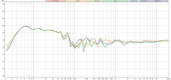

I picked up a marantz 7705 on Friday as I wanted to try atmos and Audyssey. Audyssey in about 30 minutes got these results:

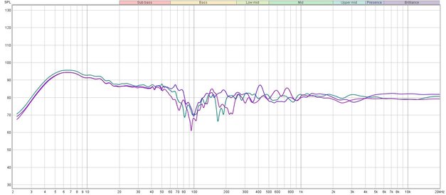

I then took the marantz out of the chain and put my previous processor back in. Using the minidsp and the 5 band PEQ on board my processor I got these results:
So different, but neither is objectively better than the other. I can probably fix that dip in the right channel by tweaking the distance on the right channel. Audyssey overcooked the bass a bit but it did a really good job. I was epxecting it to be bad but it was very listenable. Other channels showed similar results, all very tightly grouped. Overall my responses were slightly tighter than Audyssey.
