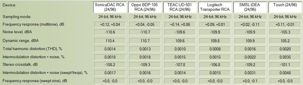

Ok so the real impetus for this posting and this adventure is, as mentioned previously, the realization of two things:
  1. There exist today digital systems whose measured performance is state of the art and at a price that anyone could easily afford
  2. That my receiver and other components may not offer this state of the art performance and as a result resolution is being lost in translation
I came to this conclusion because of a blog I enjoy reading. I am not endorsing this blog or what it says, but I'm a sucker for measurements in a review and it was one of the few places measuring stuff I cared about. In the blog he measured an S.M.S.L. IDEA DAC which had state of the art performance equal or close to equal to that of the TEAC reference dacs and the Oppo BDP-105. This DAC costs less than $100 and can be connected to your phone or laptop for portable use, while still offering state of the art performance for home audio. I found this shocking, as other small pocket DACs that he measured on the blog or in stereophile had very excellent performance, but with issues here or there. Now mind you, he is measuring through a Focusrite USB interface whose A/D converter is likely a limiting factor. It is possible that -110db is the noise limit of his system. This may not reflect 24 bit resolution but it far exceeds 16 bit.
http://archimago.blogspot.ca/2017/06/measurements-oppo-sonica-dac-ess-sabre.html?m=1
See this for a set of measurements which include he idea dac. B5F9F6EA-1727-40CB-A932-898F230F4428.jpeg
Look at that chart. Those are impressive numbers.

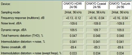

http://archimago.blogspot.com/2013/10/measurements-onkyo-tx-nr1009-as-hdmi.html?m=1
Now look at this link. It’s a receiver similar to mine in age and componentry. A bit higher end model even.
Now look at this. Similar dynamic range but much worse noise floor and much higher distortion.
That rise in distortion is actually largely an increase in both noise floor and odd order distortion. What that doesn’t show is the increase in higher odd order distortion which is still low (but much much more audible at lower levels than lower order distortion).
So all this made me think that a better preamp with lower noise and a better dac with lower noise and distortion might be worthwhile. Is it audible, I can’t say. I’d like to find out.

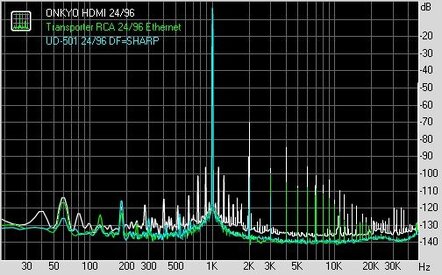

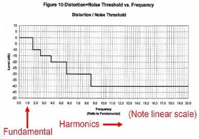

Here is a distortion example for comparison. First I’ll show a graphic that gives the threshold of hearing by harmonic accounting for masking.
Now look at a harmonic distortion plot for the onkyo
Those spikes reflect the harmonics. You will see most of the low order harmonics are low enough in level to be inaudible. The high order distortion is much higher in the onkyo than the other gear but still likely inaudible.
