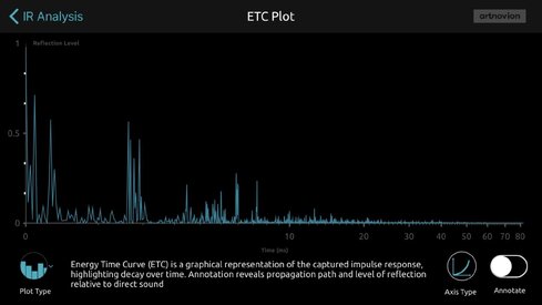

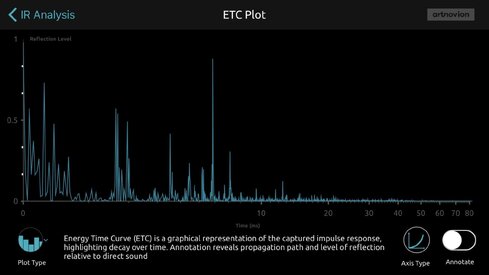

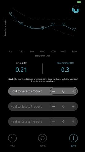

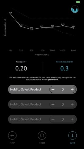

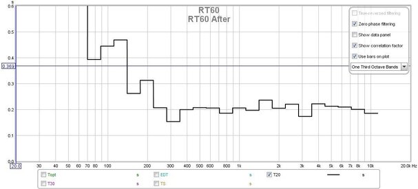

Here are a set of measurements I took before and after adding a bass trap and two additional panels to my already treated room which shows a similar improvement to that book.

This is an older one from when I had only put up the linacoustic on the front wall. No bass traps, no cloud, no side wall treatments
Ignore the 500hz dip. It kept showing up and turned out to be caused by the position of the cord near the mic tip. I didnt realize until later when I moved the mic and chord and got an otherwise identical result without the dip.

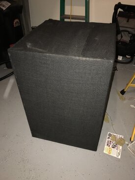

Here is the 24”x24”x36” bass trap I built for the GTG.
To equal the impact of an eq device, I would need to deploy roughly 10 of these strategically, if not more.
As for being responsible, Skip I treat my work as a reflection of me. If my work doesn’t meet my expectations I will feel responsible. It’s just my work ethic. If this room isn’t one of the best sounding rooms I’ll feel like I let you down. Hence why I want to do this right.
