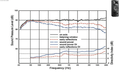

The speaker really does measure well. There are some very high Q resonances around the speakers response that can be seen in some of the measurements, but I doubt they are audible. It is my belief that fixing those would require further optimization of the waveguide and compression driver. It is likely that it would cost a fortune, take a lot of time, and lead to a very limited improvement in sound, if at all.
Thanks for taking the time to measure and review these speakers. It's a lot of work! I also applaud the Spinorama chart. IMHO it's the right way to show this type of data.
However, with all due respect, your data is suspect. The tip off for me that there is something amiss in your calculations is most easily seen in the early reflections curve. That curve should be the average of ± 40°, 60° and 80° horizontally and ±40° vertically. If you average these curves as you show in the horizontal response family in your report (in your mind's eye or otherwise), you will not get the early reflections curve you show in your Spinorama chart. The power response and DI curves look commensurately incorrect. This is a more directional loudspeaker than your Spinorama chart suggests.
I am attaching some data from a speaker I measured that has similar high frequency directional characteristics to the one you report on for reference. (Please note that the low frequency resolution of this data is good only down to about 400Hz)
View attachment 38129 View attachment 38130
My data is fine, yours makes no sense. Why would the early reflection response and the sound power response (which includes data from 360 degrees) nearly match each other? Our 0-90 degree data looks similar, our DI's look similar, its just the early reflection response that differs and its yours that looks suspect, not mine.
Look at the JBL M2: 1613145766246.png
Notice how the early reflection response is only down about 5dB and the power response down about 10dB, a little less. Go look at my data again, it shows it is down more than that because its a more directional speaker than the M2.
The speaker was measured at 2 meters outside in a large open area. The speaker was on a stand such that the tweeter was about 8' off the ground or so, maybe more. The process to capture the data was simple. Align the mic on a large long boom stand I made to the center of the speaker in the on-axis position. Take a measurement. using an electornic angle finder, move the speaker in 5 degree increments off of the 0-axis. Measure again. Label the measurement.
To be sure it was right, I not only captured the data in both directions horizontally, but did so more than once. I didn't have any anomalies in the data and the process is pretty hard to screw up.
Look at the JBL M2: View attachment 39298
To clarify my point, let’s look at your horizontal response curves at 10kHz. The 40° curve is 6dB down from the 100.5dBSPL reference at 93.5dBSPL. 60° is 17.5dB down at 83dBSPL, and 80° is 25.5dB down at 75dBSPL. The early reflection curve is the average of 8 measurements made at ±40°,60° & 80° in the horizontal plane and ±40° in the vertical plane. Your early reflection curve is down only 3.5dB at 97dBSPL. See the problem? Perhaps I’m misreading something…
The reason that the early reflections response and the sound power nearly match in directional speakers like the one I am highlighting, is that so much of the speaker’s output is biased to be directly in front, that, even though there are many measurements from the sides and around behind the speaker, they don’t contribute much to the total output but bring the average (sound power) down. The sound power being the weighted average of all measurements gets a lift from the inclusion of the all the measurements out in front of the speaker. The early reflection curve doesn’t get that help. In a directional speaker, the curves that go into the early reflection average are already approaching the levels measured back behind the speaker. Of course, the higher up in frequency the more pronounced the effect. Hopefully, this helps explains why the early reflection curve and the sound power curve can converge especially as you go up in frequency.
Regarding your comments on the DI curves, your chart shows a DI of about 7.5 in the top 2 octaves. In my example the DI in that region is about 11. A difference of 3.5 over 2+ octaves is not similar in book. Yet, you are correct that the 90° horizontal curves are similar. This is part of why my eyebrows went up when I first saw your data.
The M2’s sound power is down ~7.5dB in the chart from 700Hz all the way to 7kHz then falling a bit from there. It’s quite remarkable! In the speaker you are profiling, you are essentially showing that it has the same sound power and DI as the M2 in the top couple octaves (albeit with a good bit “rattier” looking curve). You correctly state that this speaker is more directional than the M2 but your charts don't show it. I have to say again that there is something suspect in the data you are showing.

Yes I have, in fact, I've heard them along side the Abbey's before. I also have some measurement data on the Abbey's and M2's. To really compare the measurements of the Abbey's to the M2, you have the eq the response of the Abbey since it was never as flat as the M2 until the active version was released. I also have a linear phase version of the Abbey that has some of the slickest measurements I've ever seen, the M2 could only dream of such things, but it isn't practical to implement at all.
My opinion is that Geddes tunes his speakers to be far more "dull" or warm sounding than the M2 and so in back to back uneqed comparisons they don't stand out as much. I think imaging is similar, sound overall is similar, just a difference in tonal balance. The JTR's are a bit brighter still, though Jeff took my suggestions and warmed up the sound a bit and I would say its probably closer to the M2 now (I haven't heard them back to back though). The JTR is not as refined or well behaved as the M2, but it also has WAY more output. In actual listening tests I would guess people would have a hard time telling them apart.
When I heard the M2 the amps that were supplied with them were very noisy with a lot of hiss. I've been told something was wrong with that setup for that to be true, but the person who set them up was from JBL, so I have a hard time believing that. I did hear a prototype passive home version of the M2 that has since gone into production in a refined form. That speaker was excellent, I would love a pair. Still too bright for my taste, but easily fixed.
The M2 image control waveguide beams at very high frequencies more than the OS waveguide that Geddes developed. I don't really know why and I don't know that it's audible. Once normalized and referenced to the optimal listening axis, the Abbey has a much smoother/flatter DI than the M2. It's academic in my opinion, I don't hear an obvious advantage, but I've thought it probably suggests that the image control waveguide wasn't the optimal solution to that problem. The CD that Geddes prefers, the B&C DE250, doesn't extend out past 20khz, in fact it really doesn't extend past 15khz all that well. The JBL M2 obviously has a response that extends well past 20khz. Is that an advantage? Looks nice on paper, but I don't really know. Again, once I EQed the setups to have a similar listening axis response (0 degrees for the M2 and 20 degrees for the Abbey) I didn't hear much of a difference, if any. I wouldn't want to be blinded and asked. At the time that I did these measurements I was not able to get what I think are accurate distortion measurements, but for what I did capture, the M2 had a lot lower distortion. We can debate if it was audible, but the Abbey distortion is typically over .5% for it's entire bandwidth at any level. The M2 seemed better, so much so I questioned if we were measuring the speaker or amps distortion at times.

I am very happy that you described in detail the differences between the M2 and the Abbey. As you are already aware, I still have and still listen to the Gedlee NA12, or New Abbey 12. The measurements are on Earl's website and with the Polar Plot program, you can see how fastidiously flat the DI is specifically over 1Khz to 10khz. The dispersion angle seems to be held at +/- 50 degrees or a little less. The M2 is wider and I figure the JTR Noesis is a little narrower than the Abbey and NA12.
When I first listened to the NA12, after having owned the Abbey for over 4 years, the biggest difference I heard was in the high end extension. The tweeter for the NA12 is different, it is the neodymium version, the B&C DE-500. The Abbey was far more 'dull' as you state but to me the NA12 sounds more neutral although it is slightly warm compared to other loudspeakers I have listened with ribbon tweeter, planar magnetic drivers and the like. I definitely prefer the NA12, especially at higher SPL's (~ 85-100 dB at 12 feet away); in fact it's downright dangerous because you really don't know how LOUD it really is until you pull out the SPL meter.
It's an absolute shame that there are very few examples of the NA12 in the wild but there are more of its big brother, the NS15 (New Summa 15). Both of these speakers use 18 inch OS waveguides. If you ever come down to NC, you are more than welcome for a listen!
