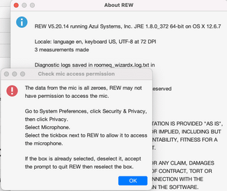

I'm having trouble getting the microphone permission to work on a MacBook running Monterey (12.6.7). It seems to be broken on all 5.20 versions including 5.20.14. It works fine using 5.19. I've tried to follow all the work arounds. Is there any debugging information I can provide to help fix this issue? The overlapping screenshot shows the permission checked, with the error box over it. -Dave

That's not a macOS permissions issue. That was a bug in REW that was fixed with the latest early access build.

I deleted the previous installation, downloaded 5.20.14ea69 from the link you provided. Now there is no permission in the privacy box for Microphone, and I'm still getting the message. Attached is the error, and the file list of the installed REW app.

Quit REW.
Open Terminal.app and type in the below:
sudo tccutil reset Microphone
Plug in the Umik and select it as the input device in Audio MIDI Setup.app
Start REW and open the RTA window.
Click the capture button to start the RTA.
The OS prompt for microphone access should display on the screen.

Thank you for sending these suggestions. I've tried them several times and it still isn't working. Is there a log file or something I could send somewhere to help in the debugging?

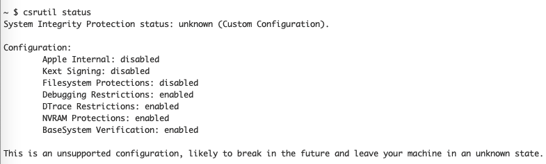

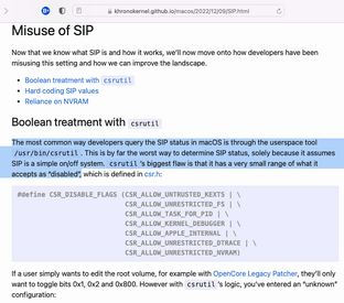

Thanks for the suggestion. I am running on an older MacBook with OpenCore Legacy Patcher. I'm now wondering what changed between 5.19 and 5.20 regarding the csrutil status? I found this site with a google search, I need to post a screenshot since I don't have enough posts to type in the URL.

In the 5.20 builds the mic permission is part of the code signature, per Apple recommendation. REW does not make use of csrutil or any other utility.
7,403
Apple's handling of permissions changes with each new OS release. I haven't come across issues on current macOS releases but then I didn't see issues with 5.20 builds on macOS 12 either.

I guess OpenCore changes some of those csrutil settings so they can load the compatible drivers during boot up. That is probably the cause of the issue.
This is exactly the cause of your issue. The changes to macOS in the name of increased security have spawned a whole new ecosystem of hacks to get newer versions of macOS to run on hardware that it was never intended to run on. While it may be a 'fun' academic exercise, you eventually will run into a blocking issue that makes it harder to justify the time spent getting it to work.
