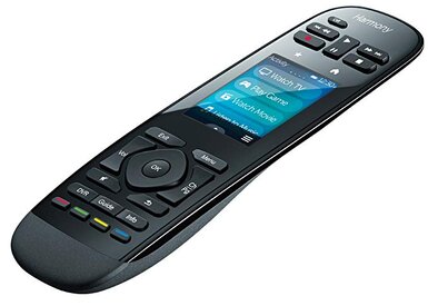

Programming the Harmony Ultimate One;
1. I started the My Harmony app and logged in to my account after setting it up. Connecting the Harmony Ultimate One via the supplied USB Micro to standard USB was easy enough through the port hidden behind a small flap at the base of the remote.
2. Once you log in the welcome screen confirms your ID with a “Welcome, Thomas” (in my case, of course). Select the box “Add a Remote” and you are off to the races. Since I had already connected the Ultimate One remote it was a simple matter of selecting the correct model. If you have not connected your remote the app will go no further.
3. You will get a graphic of your selected and connected device with some choices beside the picture of your device. These choices are how you set up your remote and should be followed in descending order unless you are doing some changing or tweaking.
a. “Your Devices” – Have the make and model number available for each device ready!
b. “Your Activities” – These are the macros that will give you that “One-Button” start power.
c. “Change or Fix what a Button Does” – Tweaks and Changes to the Harmony standard button action layout
d. “Your Favorite Channels” – Add a vendor specific channel list or modify as needed the “Favorites Channel” display​
4. Select “Your Devices” and add each device that needs to be controlled by the remote as needed along with the necessary control information (such as input on the TV and so on). The list of included IR control codes is extensive and I had no problem locating both manufacture and model number for all five devices and loading them into the app.
5. Once your devices are loaded exit “Your Devices” and select “Your Activities”. “Your Activities” is the Harmony code word for Macro and there is a lot of power here including a “Custom” activity that allows you to pretty much do anything with any of the devices loaded. Each “Activity” is programmed using your list of “Devices”. Simply add your “Activity” and select the devices that will be used to accomplish that particular “Activity”. Once selected the remote takes care of the rest.
While I selected “Watch TV” for the cable programming, “Watch Movie” for the Blu-Ray, you can change this to read “Watch Blu-Ray” if that makes more sense to you, and lastly “Watch Apple TV” for the Apple TV. There is no limits to the “Activities” you can set up but I suspect the laws of diminishing returns will eventually set in if you get too fractured setting up too many macros…. Exit and proceed to the next step.
6. Modify your buttons or touch screen actions on the remote as needed by selecting “Change or Fix what a Button Does”. For simplicities sake I did not modify any of the buttons leaving the action choices up to the Harmony pre-programmed selections.
7. Moving to “Your Favorite Channels” provided a neat surprise. Once you enter your country and Zip/Postal code Logitech provides a list of service providers in your area and their channel lineups. You can easily select up to 50 favorites to include in the list. That list is displayed by tiny buttons in color on the touch screen display. If there is a logo associated with the selection then that is part of the button displayed. I don’t know just how complete this is but it worked well for my area (Dallas).
8. Once all of the above is complete simply go to the “Sync” tab and you will upload all of your selections and setting to Harmony Ultimate One.
9. I stopped at that point and tested everything using the IR blaster on the remote. After a few minor corrections and re-syncing with the My Harmony web storage bin I was happy that it was working and moved on to the programming of the Harmony Hub.

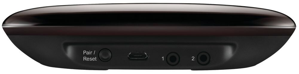

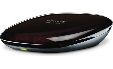

Harmony Hub Notes
As I perused the instructions of both devices looking for a way to pair the two I became a bit frustrated. Although all the descriptions and literature indicate that the Ultimate One can use the Harmony Hub as a IR repeater there is nothing in the printed instructions of either that tell you how to do it! I had to Goggle the instructions and finally found them on the Logitech website. I also found that if I proceeded with the My Harmony setup adding the Hub as a new remote I would have eventually been able to pair the two. Instead I wasted time by connecting the Hub directly to the computer and adding it to my device list. This worked but it is a bit awkward when it can all be done wirelessly.
In the end I paired the two by pressing the pairing button on the back of the HUB and then pressing and holding the Menu and MUTE buttons simultaneously on the remote. This also gave the opportunity to wirelessly “Sync” the two devices loading all of the same information from the Ultimate One remote to the Hub.
Once paired you should connect the Hub via Wi-Fi to your network and the Ultimate One will resync and follow suite.
Once I finished that I discovered the supplied IR “blaster” wasn’t much of a “blaster”. The Hub itself is a IR emitter, and seems to be a fairly good one, but the second plug-in blaster supplied is rather weak-kneed. Since the Hub actually has provisions for two IR emitter outputs I ordered another generic four IR emitter array and a 3.5mm to 2.5mm adapter and waited the obligatory Amazon Prime two days for arrival. Once received I was able to successfully add the emitters over the IR receiver eyes on all of the components and this worked very well after turning on the IR emitters in the Hub settings.
Yes, to get this to actually work you have to go into the settings, this can be done on either the Ultimate One or on the My Harmony app (or even the Harmony Control app on your smartphone or tablet) and tell the HUB to use all IR emitter outputs for each device. If you don’t do this it will default to the Ultimate One IR Blaster only and the Hub IR emitters will be disabled leaving you with no control of the components behind closed doors or out of the line of sight.
Once you make any change on the Ultimate One remote control it will automatically sync those changes to the paired Hub.

1. Unless bought as a package with the remote and the Hub already paired the instructions supplied are a bit ambiguous and weak in this area. Once paired the system seems stable enough and the units sync any changes back and forth over Wi-Fi to each other when something changes.
2. Only one IR “Blaster” is supplied with the HUB even though there are provisions for two. Happily the Hub itself functions as another IR emitter and there are plenty of cheap IR emitters available that the Hub will drive. You may have to purchase an adapter as most third party IR emitters are terminated with a 3.5mm plug and the input to the Hub is 2.5mm.
3. The supplied IR Blaster is weak. If you want to add a second Logitech OEM IR Blaster (not recommended) it will cost around $40 bucks (Crazy!)
