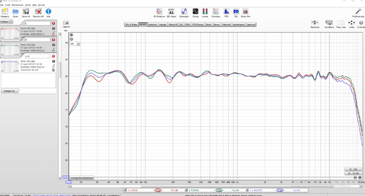

And the average amplitude response was looking like this at different positions around the center of my SOFA :
33765
I can't tell for sure the system response at listening position, but it was quite flat because I used the setup and the sound was really good at that time (however, I applied a target curve to increase by abount 8-12dB the basses below 120hz :p).

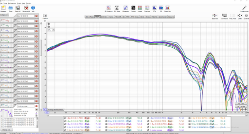

So, because the sound was good, I was trying to see how it would be replicated with my headphones. I used these modded headphones: https://drive.google.com/drive/folders/1IxrfG6SA8HqXYztnUiUc7RoqRb9KBIe2?usp=sharing
The in-ear response of the modded headphones are approximately looking like this:
33766
When wearing the headphones, my audio system was sounding really good, as if I had no headphones on my head. So I assumed that the headphones was quite 'acoustically transparant" and had, at least, a negligible effect on the perceived quality of my system response, as perceived by me.
