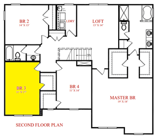

Hello to everyone! If you're here to offer advice, the more the merrier! If you're hear to browse, I hope you pick up something useful.
I'm in the process of building a new home. One of the upstairs bedrooms will serve as the dedicated theater (#3 in the attached image). Assuming the gear will play into the conventional long dimension, how do I plan the screen size / seating distance ratio so that main speaker positions are taken into account? Looking at the drawing and paying particular attention to the window and closet obstructions, where would you place your screen and why? What are the distance considerations for the projector? I have absolutely no idea where to start because the alphabet soup of screen/display ratio's boggles my mind.
EDIT: Sorry for the oversight... Would you buy or paint your screen on the wall? Why or why not?

Hey Sufferin, do you have any speakers now that you'll be using or have anything in mind?
What are your plans for seating, i.e. how many?
Looking at a projector that will do HDR, either 4k or faux k (pixel shifter) or sticking with 1080p?

I had a painted screen for a couple years before I bought a fixed screen and I can say that paint just does not cut it in my opinion. the "proper" screen paint is costly and is still not as effective as a real screen. I still have a nice Jamestown screen that I bought 12 years ago and its held up really well.

Yes, JStewart, I’m locked-in to using my existing Revel Ultima Salon & Voice for L/C/R duties. The screen would not need to be acoustically transparent, because the center channel is too large to hide behind a false wall.
I’m thinking of swapping out the PSB Image B5 rear surrounds for a pair of SVS Prime Elevations, and adding a pair of same for side surround duties.
There will probably be two rows of seating: traditional theater seats in front with a couch behind. And as far as resolution goes, I’m locked into 1080p for the time being. Unless big-screen (90+ inch) viewing at proper distance would prove to be too grainy, I don’t relish spending he money to upgrade my player and AVR at this time.

Not expecting anyone or everyone to do my homework for me, I found out that this new 11x17 room may not be large enough for projection. I also determined I prefer. 2.4/2.35 aspect ratio screen primarily for movie viewing.
Generally accepted viewing distance is often quoted as 1.5xdiagonal, though personal preference plays a role. Left to my own devices in a formal theater, I tend to sit about 1/3 back from the screen. Assuming a conventional 1.5x design, my first row at home would need to be about 12ft back. That doesn’t really allow for a second row of seating or optimal positioning of the rear surrounds.
So it seems my new room is a bit smallish for projection. What do you think—is it really an “upgrade” to replace my 60” plasma flatscreen with a marginally larger projection system at much greater cost?

My room is like 9.5'x17.5' and I have 3 rows, a 115" diagonal 16x9 screen that I have semi-permanently masked for 2x1. And that's with a false wall and acoustically transparent screen. Granted, I was able to use a couple blocked out window-wells and cut another hole in the wall for speaker depth, so I only really lost about 6" with the false wall, but still.
It's tight, but it's not crowded. I've had 10 theater enthusiasts in there watching a movie before and heard zero complaints.

Now that I’ve visited your showcase, Kudos to you and your Diamond Street Cinema! That didn’t happen by accident. I imagine the soundfield from your front stage is quite impressive with a matched, vertical center channel.
Crunching numbers for your screen size confuses me. More research on my part is needed! I can understand how some people
like to sit close for an immersive experience, and I may become one. I’ve always imagined the thrill of having your field of vision filled with action on a big screen. How far away is your first row?
Maybe a false wall would work for me by concealing a mount to raise my center channel (currently under screen) to be more in-line with the mains. That way the drivers which carry similar frequencies are roughly arranged in the same horizontal plane relative to the LP. In this case, the mains’ tweeters are 4ft off the ground—incidentally, that’s the distance recommended by some for minimum height of screen off the floor for good line-of-sight to back rows. In any case, I need to look into how a false wall is built. Tear-down needs to inflict minimal damage to the original structure.
So even though I’d still be “saddled” with an admittedly not-ideal-horizontal-dispersion-pattern-center-channel, at least images wouldn’t tend to nose dive to the level of its current shelf, right? I wouldn’t have a nicely matched L/C/R set with “aligned” baffles, but removing the center from between my mains tremendously improves stereo performance.
My mains will pull off the holographic audiophile thing, but only if they’re well away from room boundaries. If excellent SS&I can be achieved in that room, I’m not sure I’m willing to give it up. But maybe I won’t have to as I move along this learning curve...

My front row is approximately 9-9 1/2 feet from the screen. I can't remember right off hand.
The screen is 100" wide by 50" tall in the 2:1 aspect ratio I've been using.
The sound is awesome. I have all the materials to swap out my surrounds to match the LCRs, I just have to find the time to build the crossovers. They will basically be identical, in a slated cabinet, with only a single midrange. Same drivers, same horns, and same crossovers.
For building the false wall, I basically used the "goal post" technique. I put a 2x4 across the floor, and one across the ceiling, from wall to wall. Then I added two vertical 2x4s between them, placed between the L-C and C-R. The screen is hung on them using a french cleat that stretches across. Then I added a few more 2x4 pieces to mount the cedar on. Most people, instead of the cedar, will use a deep black fabric or velvet and make frames to place around the screen. I had the cedar and liked the look, so I used it in short pieces that only go about an inch behind the frame. Then I stuffed behind it with leftover carpet and padding.
14470
As for fitting 3 rows, I wouldn't have done it if I wanted 3 rows of recliners. It wouldn't have worked. But because my 2nd row is a couch, and my 3rd row is a row of movie theater seats, I didn't have to allow for recline space. My front row of recliners don't recline back more than a couple inches, they move down and out, so it doesn't really encroach into the row 2 legroom.
14472
Honestly, I probably left too much space between row 2 and 3. Row 3 is rarely used, and there's a ton of space back there. There's enough room behind that my sub is back there, extra blanket and pillow storage. The front edge of my equipment rack is even with the backs of the chairs in row 3.
14471
The only real tight squeeze is going past row 2 to get to row 3 and the equipment rack. I could put a more normal sized couch in row 2 and eliminate that problem if I really wanted to, but I'm more interested in moving west than renovating the theater again. That way I can start over! :)

Thinking out loud, I first had trouble wrapping my brain around how to sandwich a 100” screen along with my very large mains across the front wall without sacrificing SS&I. But then I realized I erroneously used the diagonal in my calcs. Not hard to imagine how I got the idea most installations in smallish rooms prioritize movies over music. DOH, and apologies!
On an 11ft (132inch) wide front wall, I’d be able to fit my mains on either side of a projection screen with room to spare. Needing at least 2ft (preferably 3ft) from the sidewalls for convincing holographic performance, the mains would be spaced a maximum of 5.5ft apart (on centers). Allowing for 1ft per side between each speaker and the screen yields a screen width of only 3.5ft (48” diag). Unacceptable.
Crowding the mains a foot closer to the screen edges still yields only 76” diag. Better, but still not big screen territory. It’s beginning to look like the best option for prioritizing SS&I while still accommodating HT is to place the L/C/R set behind a transparent screen.
While that may have been obvious to some of you, I had to convince myself the hard way! I now realize a false front wall maximizes both screen size and L/R separation. Recalculating for 3ft from speaker to wall sets centerline distance at 5ft. The screen size then just depends on its frame width and the associated clearance to the wall: roughly 9ft wide or 127” diagonal.
Do you think that’s a reasonable set up?

I would look at getting an Acoustically Transparent screen (AT) this way you put your front 3 speakers behind the screen and the sound goes through tinny holes in the screen material its self.

Actually, at most home theater sizes, a weave screen will be better suited than a perforated screen. The weave allow for a minimal distance between speakers and screen. Perf would require a deeper cavity behind the screen.
But yes, acoustically transparent is, in my opinion, the way to go whenever possible.
