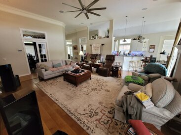

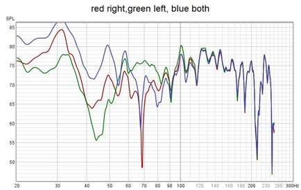

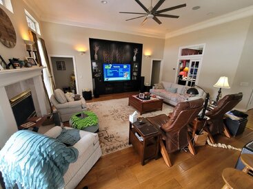

!st time REW user, Marantz 7013, 2 SVS SB13 subs, Martin Logan XT40 LR mains, Martin Logan XT50 center, Martin Logan surround and Atmos in ceiling.
Did a 1st run of REW and the results are less that good, IMHO. I have done no EQ or movement of the subs. Both subs have been upgraded to the new SB13 bluetooth amps. Looking for recommendations in how to tackle the sub placements, EQ, etc. Willing to purchase a MiniDSP if recommended.
The attachments are the REW results and 2 views of my room. The subs are on either side of the L and R mains. The UMIK1 was placed in the left brown chair in the 1st photo

I would measure both subs with the mains and the crossover in play, as your mains may help some in the 70-90Hz area.
The peak at 30Hz could be tamed with the PEQ filters in the subs... and the 20Hz peak probably won't be an issue... probably needed on movies hitting that low area. Then you could run Audyssey and smooth the rest out okay.
Thanks for the suggestions. Will give this a try later today. Should the dips at 70hz be addressed?
5,254
AVA Cinema
If possible... I would use 1/6th octave smoothing... as some of those dips/peaks are narrow and probably not noticeable.
Having the mains mixed in with the measurements may resolve that issue.

That's a beautiful room. A lot of space to pressurize, but a pair of SB13s with the SB4000 amps should do the job nicely.
Like @Sonnie said, if you use 1/6th octave smoothing or psychoacoustic smoothing, you'll get a better sense of what areas need addressing. You may find that moving your listening position a foot forward or back helps significantly with some of those dips, so it's worth taking the time to experiment. i agree that a little PEQ (in the SVS app) can be helpful to soften the peaks a bit, but it's okay to have about 1 dB per octave gain as you move down in frequency; flat is not the goal.
I'd definitely like to see plots with just the subs, just the mains, and then everything together.
