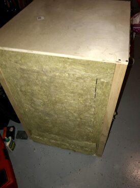

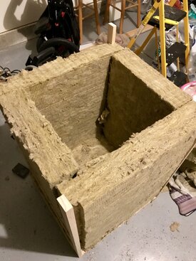

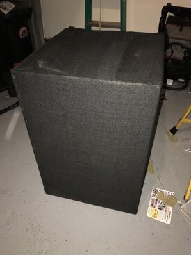

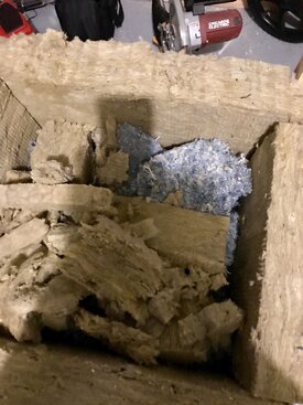

Broadband bass traps that rely on a frequency attenuated velocity absorption method are much easier to build. They are basically large rectangular boxes filled with dense fiberglass or minerwool and with a membrane of low density attached to either a face or internally. The placement of the membrane impacts the absorption response in the mid/high frequencies while the membranes density and stiffness effects the boost in LF absorption.
Here’s a picture of a box type bass absorber sometimes referred to as a soffit trap. They are usually used in corners.
4A4C979C-D48E-4658-B9B6-739362718D73.jpeg C0532F31-C621-4134-87B7-CE0E9A16CDF3.jpeg BFCD7B2C-1E03-47B8-99BA-0B61935D3A74.jpeg 2385B35F-C0D6-402E-AAA8-32CAB9DFDF0D.jpeg
The chamber style used in this trap was done because the trap is so deep at 24”. Solid 6lb mineral wool would become reflective to even upper bass frequencies and so not provide much absorption benefit.
