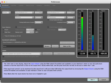

Hi there, sorry for the late reply.
Here is a screenshot of my preferences page.
My input level and output level are both at the maximum here.

The Windows input volume control shows it is at 25.4%.
It would be pretty odd if your interface couldn't deliver enough output to fully drive the input, looks like the output level on the interface is controlled by the Monitor knob.

Yes, sorry, OS input volume control is at 25.4%.
The OS volume is at 100%, how do I turn up the input volume of the operating system?
Edit: I've found it, it was just over 50% so I've turned it up to the max, I will try again with the calibration now.

Generally the volume control figure shown in REW matches the volume control you'll find in Audio Midi Setup.

I've managed to get the sound card calibration completed. Thank you everyone.
Sometimes it is just an issue within the computer itself (MacOS input volume) as opposed to what I was doing for the calibration itself.
