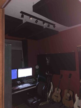

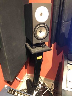

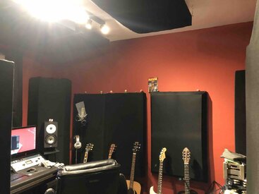

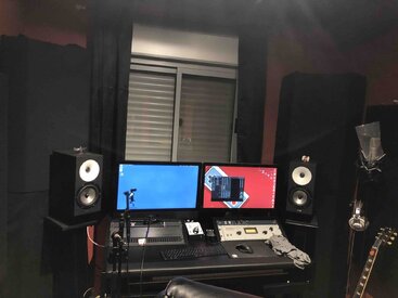

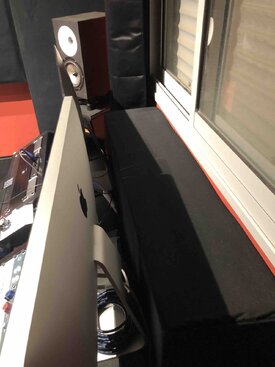

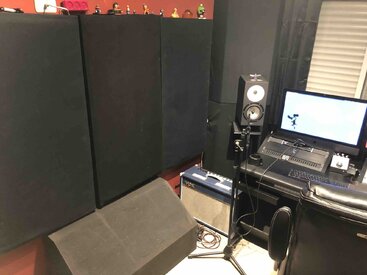

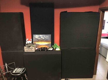

Pics:
DanDan
Mar 10, 2018
788
Sorry Soj, you need to ba able to tell what is better or worse using REW and your ears. Make the comparisons easy for yourself. You can open multiple measurements in the one .mdat file. But certainly open the ones you are comparing. Pro Control rooms can have up to 60% of their volume occupied by traps, and I have never been in one that did not sound 'dead'.
