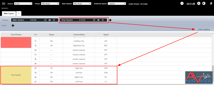

After configuring the speakers, my next step was to map each speaker to the output on the MK3. From the Main Speakers page (image I shared previously), I clicked on the [Output Mapping] button on the right side of the page. Clicking that button will bring up the mapping page shown below. The main objective here is to match each speaker to the labeled output on the back of the processor. (Click on the image to enlarge.)
After finishing the mapping, I saved it. (Our watermark covers the Save button in the image above.)

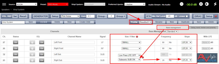

Next, I selected the Edit icon from the Main Speakers page to explore the speaker settings area for the Theater (renamed Main System) configuration I created (see the image below—click to enlarge). This page has too much information to cover in detail, but much of it is self-explanatory.
I created a Baseline profile to start with. I always select it before running the Dirac Live calibration. It is helpful in many respects. To help set up the Baseline preset, a single measurement using a single mic point can be used with the DLBC calibration to get the initial level and delay settings, which will be entered into the Baseline preset. DLBC is used for this measurement because ART requires a minimum of three measurement points and does not support a single measurement. I copied the level and delay settings from one of my first calibrations into a new profile and saved it as my Baseline preset. I'll discuss this more later.
The MK3's built-in generator can also be used with pink noise and an SPL meter at the main listening position. The REW software SPL meter with an appropriate mic, such as the UMIK-1, can also be used. I used this method to level-match my speakers and subs before running my first DLBC calibration to create the Baseline preset. It is not as precise as DLBC, but it can narrow down any drastic level variances to help with the volume calibration when running Dirac.
After running a Dirac calibration, I investigate the delay section to ensure nothing is too far off. With all of my speakers being symmetrical, I expect most delay settings to be reasonably close for each pair of symmetrical speakers. The delay settings also confirm the center position of the mic. See the example below of my first few speakers. Had I noticed any of these paired speakers being significantly different, I would have investigated for the cause.
Using the Baseline preset with levels already set, the volume calibration levels shouldn't need to be adjusted for every Dirac calibration because the levels will already be very close to level. This saves me some time since I have 23 speakers. I have adjusted the master volume and skipped the remainder of the volume calibration for each speaker without any adverse effects thus far. The levels may change slightly after the ART calibration.
I also set up PEQ filters (see next section) to reduce drastic peaks in various speakers and subwoofers (all PEQ filters were from 44 Hz and up), then saved them to my Baseline preset. Using the Baseline preset should make the calibration process lighter for Dirac. Hidden below are a few measurements comparing the RAW output of my left front + subs vs. the BaselineEQL preset with PEQ and levels set vs. BaselineEQLD with PEQ, levels, and delay settings.

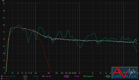

The image below shows the measured results of the slider option target curve. (Click on the image to enlarge.)
Notice the brick wall that ART creates at 20 Hz. This brick wall is unique to ART and is not used with Dirac Live Bass Management or Bass Control. This leads me to the next section, which discusses how this brick wall can be removed.

Child Room
It's not what it sounds like. I have just set up this nice theater room, but I also want a strictly two-channel setup for vinyl or music that I only want to hear in stereo. I don't want any help from all these other support speakers. I only want my two front speakers playing and two subwoofers instead of all eight. This room setting is also helpful for reviewing speakers where I only want to play the front speakers, and perhaps I want to run a new Dirac calibration for only those speakers. I can create any configuration of speakers I want.
The child room is created from the Main Speakers page settings. The image below shows the upper left corner of the page. I click [Create Child].
Clicking on the [Create Child] button will open up a dialog box where I can select the speakers I'd like for the child system I am creating. I have selected my two front speakers and two subwoofers. I can also create a mono system here. Once I choose my speakers, I can tick the box to [Keep Dirac Profile] if I want to use the current Dirac settings. I can also uncheck it to listen to the raw speakers or run another Dirac calibration. I can confirm that, in all likelihood, the [Keep Dirac Profile] box needs to be unchecked, as what it retains is like a box of chocolates. It is better to rerun Dirac if a Dirac calibration is desired. I then save my selections. (Click the image to enlarge.)
I now have another system set up within the same room.
If I click the Edit icon for my Two-Channel room, it opens my settings, where I can make changes or run a new Dirac calibration for that specific room. (Click the image to enlarge.)

The Baseline preset is the raw output with a few peaks removed from the subwoofers using the PEQ filters in the MK3. It also has Dirac Live delay and level settings entered from a previous Dirac calibration. It represents the output as if Dirac has been switched off but retains the delay and level settings. The MixedMic9 preset is the Dirac calibration with nine measurement positions around the primary listening position, while the FixedMic3 preset only has three single-point measurements from the primary listening position.
The REW measurement graphs below show the frequency sweeps of both front speakers from 20-20,000 Hz for the Baseline, MixedMic9, and FixedMic3 presets and one graph of the left front for all three presets combined. Later, in the Infra-bass Results section, I will show the frequency sweeps from 5-200 Hz.
All images are labeled at the top of the image. (Click on the images to enlarge.)

Modularity: Vinyl Room
It might seem like this section should have appeared earlier in the review, but it was close to the last piece of the puzzle—so to speak. One of my vinyl setups shares space in my dedicated room with my main home theater and listening system. This vinyl setup has a Music Hall Stealth turntable feeding into a miniDSP ADept phono stage. Previously, it fed a miniDSP SHD processor. The SHD outputs were connected to a pair of SVSound 3000 Micro subwoofers and a McIntosh MA252 amplifier powering my Wharfedale Super Linton speakers. The miniDSP SHD only has basic Dirac Live and lacks the robustness of DLBC or DLART, and I haven't been able to get it to sound like I wanted. So... I upgraded my 24-channel MK3 to 32 channels and integrated my vinyl system into the MK3 to gain access to DLART for my vinyl system in hopes of getting the sound I wanted. While winding down this epic novel, I figured, why not add one last chapter?
The upgrade must be performed by an authorized StormAudio dealer. Fortunately, I have a close friend who is a dealer, and the process took less than an hour. The upgrade involved replacing the 8-channel output panel with a 16-channel output board. Since I already had the 8-channel panel, an additional DAC board was not required. However, for a 16-channel unit, the DAC board and the output panel must be replaced. The upgrade was plug-and-play, requiring no firmware updates or additional configuration. Once powered back on, the eight extra channels appeared automatically. I used four of these additional channels for my vinyl system. This upgrade eliminated the need for the SHD. I can now switch presets in the MK3 for vinyl playback, assuming my McIntosh amp is powered on. Additionally, I can still route any source through the vinyl system. Like the Child Room, this setup makes swapping out amplifiers and evaluating speakers for two-channel listening incredibly easy. Additionally, if needed or desired, I can create a new layout with a new theater and incorporate any number of my larger subwoofers from my main system instead of relying solely on the SVS 3000 Micro subwoofers.
Creating the Vinyl System is easy enough. I opened the Main Speaker page from the menu and selected the [+] icon to add a new Theater.
Clicking this [+] icon opens the Configurator, where I add a subwoofer to change the default configuration from 2.1 to 2.2.
After saving the configuration, I am returned to the Main Speakers page, which will show my added Theater, which I renamed Vinyl System. Next, I will click on the [Output mapping] button and map the speakers appropriately to the channels they are each connected to on the rear of the unit. I have already saved the mapping in the image below. (Click on the image to enlarge.)
Now, I am ready to create a Baseline profile and preset. I click the [Edit] icon to open the speaker settings page. (Click on the image to enlarge.)
I changed the default New Profile 1 to BaselineV on the speaker settings page, representing my Baseline vinyl preset. As a precaution, I set the subsonic filter to 20 Hz since the SVS 3000 Micro subwoofers are only rated to 23 Hz. (Click the image to enlarge.)
I ran the Dirac calibration as a first run to obtain my levels and delay (not required) as a convenience for future calibrations. These values were entered into the BaselineV preset and saved. Afterward, I ran my normal Dirac calibration for ART. Since this is a fairly simple ART setup with only a 2.2-speaker configuration. I left the [Support Levels] at the default of -18 dB, set the [F-support Low] to 80 dB for the speakers and 25 dB for the subwoofers, and did not change the default [F-support High] of 150 Hz. I allowed them to support each other. After running ART, I saved my preset and named it Vinyl. When I select the Vinyl preset, the MK3 automatically switches the system from Main to Vinyl and vice versa. As mentioned earlier, my McIntosh amp will need to be powered on for the vinyl system to play, as well as the turntable and phono preamp, if I desire to listen to vinyl, which is the reason for the vinyl system.
Below are the REW measurements of the left front and subwoofers before and after ART. Since system decay was minimal for this system, and ART produced no meaningful improvement, I did not see a need to post any of those graphs. (Click the image to enlarge.)
I had been seriously struggling to make my vinyl system sound right in my dedicated room with the SHD processor leading the system. I had second thoughts about leaving it in the room, not that I had anywhere else to set it up. After integrating it with the MK3, I discovered that one issue may have been improper time alignment between the speakers and subwoofers. I manually measured the distance and entered it into the SHD settings, but it was significantly off, according to StormAudio’s Dirac calibration. Another challenge was crossover integration. No matter how many different crossover points I tried for the speakers and subwoofers, I couldn't achieve a smooth transition in the measured response. Placement may have also been a limitation. I had previously used the SHD in this room with my main speakers and multiple subwoofers, and it performed excellently—but I had greater flexibility in speaker and subwoofer placement then. Bottom line... I was disappointed with what was happening with my vinyl system and my inability to get it tuned right. Upgrading to the extra channels in the StormAudio MK3 and integrating the vinyl system into the MK3 was my last resort to see if it would help.
Once again, the StormAudio MK3 and ART proved to be nothing short of impressive. After setting the system up with ART, I was astounded by how good it sounded. The SVS 3000 Micro subwoofers blended perfectly with the Wharfedale Super Lintons. Switching the presets back and forth and comparing the main system with the vinyl system while listening to Roon was a treat. Naturally, the vinyl system couldn't keep up with the main system at louder volumes or with extended bass response, nor was the soundstage as large. However, at lower volumes, they were not miles apart. The imaging was spot-on in both systems, and the overall tonal qualities were similar. Each system has its own character, but it is not as drastic as some might think it would be. The vinyl system is perfect for vinyl listening because I listen at lower volumes, mostly for background music while writing, researching, or chatting online. Trying new speakers in the room will also be fun as opportunities arise. Thanks to the StormAudio MK3 and DLART, this vinyl system has found a permanent home in my dedicated room. Touchdown, MK3... keep piling on the points and running up the score!
