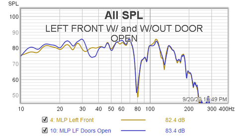

Here are a few measurements... No Smoothing
35148
35149
35150
35151
35152
35153
35155
35156
