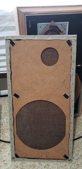

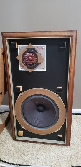

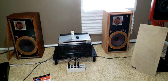

Happened across a pair of these last night, swooped in to pick them up today from the owner of Zealth Audio.
The NOS tweeters have basically no hours on them, he checked the crossovers and three position tweeter switch and I checked the newly foamed woofers for voice coil rub. All good and they sound great!

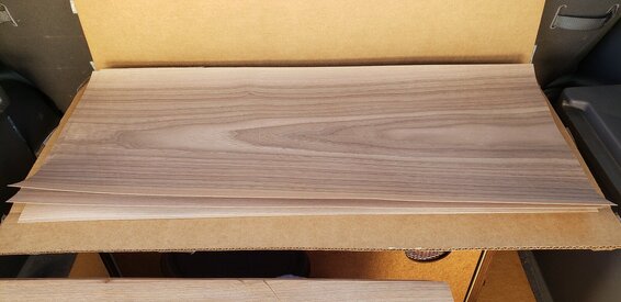

Also thrown in is a walnut veneer stack, which I'll have a cabinet maker apply for me. I'll need to replace the fabric on the grilles, which is an easy fix and will complete the restoration. Now I just need to get some speaker cables with little spades on the speaker end and bananas on the amp end for easy swaps.

Had to order some adapters so that I could plug in banana-terminated cables, finally got to hear the in my dedicated room. One sounds really nice and polite, the other is brash. The contour switches are at neutral, so I think it is time to rebulild the crossovers.
