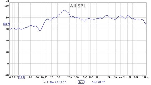

1. Single Wire Speaker - Single Run of Belden 10 AWG – Speaker Jumper in Place
Room Curve 1 – Single 10ga Cable – Speaker Cable in place​
This was my reference base... The sound to which I was familiar and have been living with for a while. While I normally listen with the Subs on, I have done listening without and this was what I was used to and expected. A smooth, full range sound with a well-defined, but somewhat lacking bottom end.
The room curve reflected what I was hearing and expected. Without the subs engaged the curve rolled off pretty quickly on the low end. The published specs for the BG Radia FS-520i are 70Hz to 20,000Hz +/- 6db and the curve reflected this at both ends of the spectrum.
I cycled through all of my musical selections trying to note something in each that might be revealing in nature if there were actually changes.

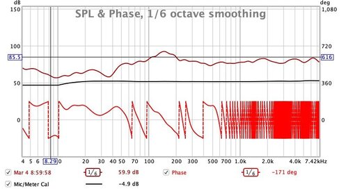

2. Paralleled Cable Runs - Double Runs of Cable – Speaker Jumper Installed
This test showed very slight changes in the measured room curve. While there were SLIGHT CHANGES to the measured sound there was certainly nothing significant or audible. Could have been changing humidity :-)

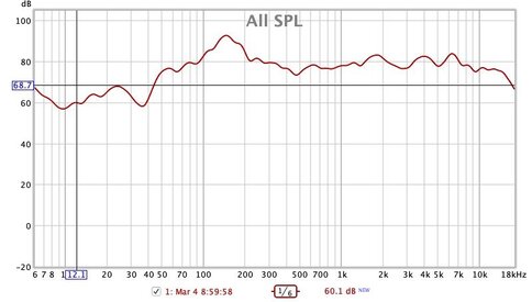

3. Bi-Wired - Separate Runs of Cable to High and Low Speaker Terminals – Jumper Removed
I went to this step expecting little or no change in the room curve and that is exactly what I got. Almost Zerochange in the measured room response. SPL showed a little flattening in the very bottom end where the speakers should not have been outputting much anyway and was probably just the noise floor receding a bit (we are near a major highway and occasionally get some noise… but that’s another project !)
Comparing SPL/Phase graphs between the three configurations showed a somewhat cleaner phase signal around the crossover point and not much else.

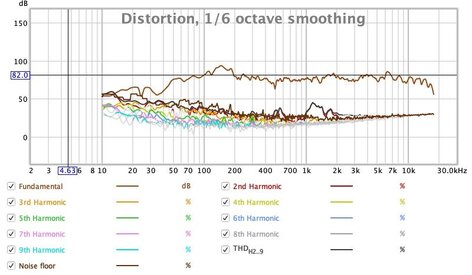

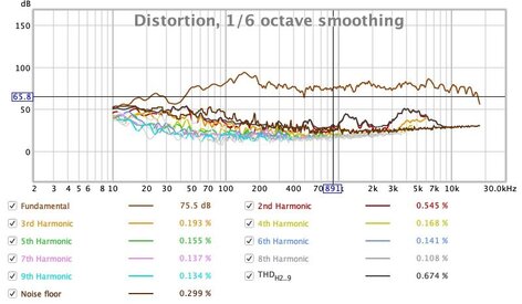

A comparison of the Harmonic Distortion graphs showed very little difference between the three configurations. Certainly nothing that could be considered an improvement.
Curve 3 – Bi-Wired (No Jumper)
Despite my disappointment in the measurements I went ahead with the listening and found that I could not honestly hear a bit of difference or improvement.
