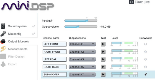

Notice that I have changed the LEFT REAR and RIGHT REAR channels to Output Channel #5 and Channel #6... and the SUB to Output Channel #7... since that is how my Routing and Mixer tabs are set.
Now when I run the measurement sweeps, it sweeps the entire front left, front right, left rear, right rear and subwoofer, then one more time on the left front. I keep my mic centered where my head is for the first two measurements... then I moved it slightly left, slightly right... slightly backwards, forwards... up a little, down a little... you can experiment, but it seems to be the consensus that taking more measurements is better. It is not averaging... it is looking for areas to fix anywhere around your head... or anywhere you are placing the mic. Some guys are even taking a measurement over on the passengers side. I have not tried this yet, but probably will eventually.

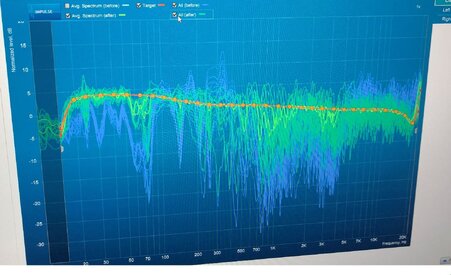

So after my measurements... this is what I see for the sub...
24364
.... and the fronts...
24365

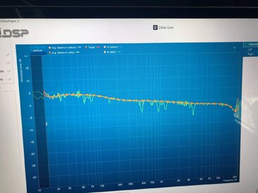

I also found that the response is better when Dirac treats each speaker group as one speaker. It does a better job at the crossover points/integration. In your Dirac tab just have Dirac 1 (left) and Dirac2 (right) with the sub on for both. Attached is my average response and another graph showing all the sweeps.

So you think I should put my target curve below my dips? I see you put your curve -10db down. I just left mine where it was by default around 0db which then required boosting in many places. Let me try that....
5,230
You could try it and see. It's always been my preference in my home because it's easier to cut peaks than it is to boost dips, although I would not let the very narrow serious dips be of any concern. Our ears won't ever notice most of those anyway.

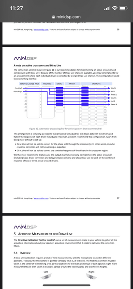

I just went back and read the active speaker section again on pg 37. They do want you to do Dirac Live with one channel for all speakers on each side (eg left woofer, mid, tweet + sub) in an active setup. This is so Dirac can better correct for phase issues at the crossover points. So in my system after I did my rough calibration and correction in REW for each individual driver I did my Dirac sweeps with everything playin together on the left and everything on the right.
