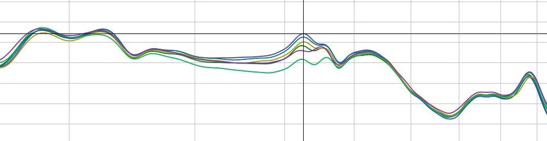

Based on my previous attemts phase changes from 75 to 105 didn't make such huge differences. Anyway, I like the first option and now it's time to enjoy listening! ;)
Forgot to mention. Tried EQ too (can be seen in mdat file). Interestingly, it is far away from REW predictions.

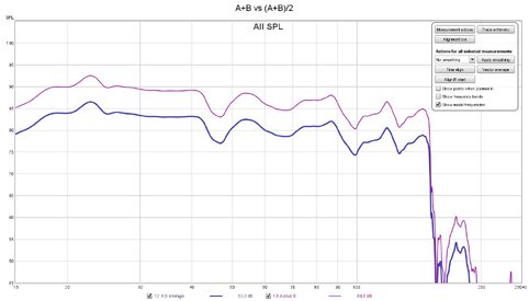

1. I see A+B, (A+B)/2 and average look pretty similar except A+B is louder. You used (A+B)/2 for all actions, I assume this is the best option? Probably it's important to use the same algorithm for all plots.
2. Delay slider can slide left and right. Sliding it to left can be set up in the AVR. What about sliding it to the right? Does any AVR offers negative delay setting?
Makes a lot more sense now why miniDSP can be very handy. It's easier to time-align subs with delay instead with phase changes. However, that's no shortcut for determining optimal HP/LP filters.

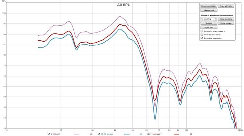

My mistake. I should have summed the 4 SWs instead of averaging them. The good news is that this does not impact Step-1; the favorable integration of the 4 SWs. It does impact the gain choice on Step-2; the handoff from SWs to mains. The SWs SPL level in my SPL charts is about 12 dB lower than the summation would have been. For Step-2 my table offered a gain change of the SWs LFE vs mains gain level of 0 dB in as a reasonable starting place. That should have been be a 12 dB reduction of gain level on the LFE output (assuming I now have this correctly in mind). In the end, the gain level between LFE output and mains level is chosen based on the listeners preference. Just adjust the LFE level as needed.
It's relative timing we found that counts. Adding a positive delay to A is the same as adding a negative delay to B. No matter the number of the speakers and subs in a system there is sound from one of them that arrives at the LP first. That speaker becomes our reference and can be set as low as 0 ms delay if needed. All the others then have more delay, but all still must retain the proper relative timing between them.
Not sure if I follow. The way I see it you used A+B average for plot SX4 (looking at mdat from post 89).
If you would have used just A+B it would not be marked with the sign "Trace Arithmetic A,B average", right?

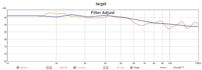

So the proper thing would be to use trace artihmetic A+B (instead of (A+B)/2 for step 6?
I suggest you not spend so much time on recreating my mistaken analysis process. It would probably be more useful to understand the correct process for your situation (see options below). Since different setup situations lead to different analysis steps we also must understand how to select the process steps needed for different situations - it takes while. You can see, I still get confused.
I now see my mistake was only in averaging SWs 1,2 and 3,4 instead of summing them. I correctly summed the 2 groups using the alignment tool. The net impact of this mistaken analysis was then to under estimate the gain level of the SWgroup by 6 dB instead of the 12 dB that I recently stated above. Again, this only impacts the plotted SPL level of the predicted LFE output. That's a level that normally finally adjusted to listener preference. It also impacts any comparison of predicted Option-1 SPL plots to new measurements of Option-1 settings as previously indicated.
I compared the A+B and (A+B)/2 and I see the sum only 6dB hotter.
That is correct summing 2 identical sounds results in a 6dB gain. The alignment tool uses vector summation. Summing 4 identical sounds results in a 12 dB gain. SWs measurements are not identical sounds so the actual vector summation of the 4 will probably average less than the max 12 dB possible.

As I noted it's the relative LFE level compared to the mains level that is impacted by this mistake. The actual level LFE level you prefer may be very different than the one I might prefer in your room and I have no way to know what level I might prefer. Adjust the LFE to you preference is the message. I only pointed this out as a mistake to so that if you measure the option 1 settings and notice that bass level is significantly higher than the mains than I charted you would understand why. There was nothing special about the level I plotted. I just looked at the response with no LFE level change and decided It look reasonably good without change.

I believe there could be an universal rule. Measure L, R and each sub together.
Then:
1. (A+B)/2 for mains
2. time align subs with alignment tool and sum pair if necessary
3. sum all subs with (A+B)/2
4. sum SW group + mains (here I was asking you which algorith should be used)
Here I've been wondering: when you say summing - you mean "Aligned sum" in Alignment tool? And when averaging you mean trace arithmetic (A+B)/2?
But than again, gain can be set according to taste so I guess summing algorithms are't so important?
Plus, all this can be checked/confirmed with actual measurements.
So I vote for Option 3, thank you very much. ;)
I'm happy with the result. As I posted earlier, I got pretty close to the target curve.
I added a little EQ at 80 Hz area (I gained -3dB on a graph but had to add -10dB on the subs. Looks like subs are not that active at 80 Hz).
Based on many measurements I don't think I can tame that 80 Hz peak.
I think the 120 Hz area could bother me but until I buy an AVR with PEQ there's not much I can do. Perhaps I could try locate the loudest area in my room and try some absorption.
