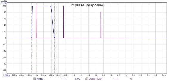

I have trouble with multiple sweep measurements:
See the attached file. View the impulse response panel of each measurement zoomed out in time with 'window' selected.
  • The first (single sweep) measurement looks normal.
  • The second multi-sweep measurements show the window changed to 0, 0, 500 instead of the selected default of 125, 0, 500. There is also a second impulse shown way to right of that window.
  • The last 2 have the window back to the default, but still show the impulses to the right of that window.
I quickly tested with 'delay start' on and off and with 'loopback timing' on and off and still had similar issues. The 0, 0, 500 change in window limit setting seems to be random with some multi-sweep measurements.

The mdat seemed to upload okay, but did not attach. It may be too large? Let me know if you need it to check this issue out.
7,403
I don't need the mdat, I've found the issue. Unintended side effect of the timing correction work, I've fixed it for the next build. In the meantime multiple sweeps won't work properly, sorry about that.

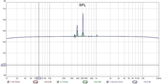

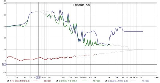

I have also noticed occasional glitches in the SPL and distortion traces. I founded a sure way to create these. Mouse click on any other window while the sweep is in process. This can be the main REW window, any other program window, or the desktop. Anything except the measurement window. This always disrupts the sweep causing a SPL and distortion glitch. While I now know to just avoid doing this I sometimes get similar glitches anyway. These random glitches are smaller than the ones shown below using mouse clicks.
I suspect that may be a hardware or PC setup issue. I am curious if others have seen this same problem. If it isn't common then I know to continue to try and find the cause of this.
  • Mouse Distortion.mdat
7,403
The measurement dialog is modal, so it doesn't allow focus to be transferred to other REW windows. On a windows system that will usually cause an error tone to be played through the default System audio output - if that is the output you are using for measurement it will interfere, best not using the System output for measurement if possible.

Thanks, that was the problem for the mouse click issue.
