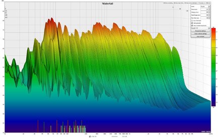

Looks to me like REL volume is way too high. Also roll off is a little too low. Try to set to 80 with REL 1/2 as loud. Also, can the REL polarity be something in-between 0 and 180? Try 160 and 200 and see if the fills in the cancellation at 60.
The REL has only 0 or 180 for phase.
I will try to set the crossover a little higher and see what happens.

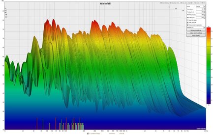

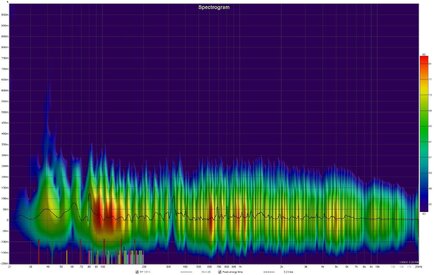

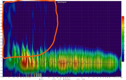

It actually did more than I thought. It brought a lot of clarity and definition, and considerable improvement in the presentation/3D.
Extremely pleased by them. Left-No_podiums.jpg Left-podiums.jpg LPspectogram.jpg LSpectogram_LI.jpg
