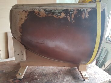

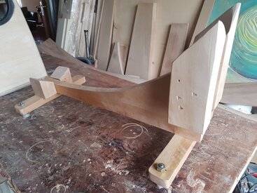

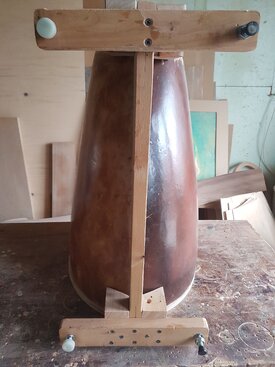

However, we reach the point where we have to measure the internal volume of the column. I am registered in more than 35 "DIY" sites and when I am asking the question , how i was made it - whether I have the right answer?
From waste material I made this gadget ,that takes part in the measurements and when assembling the cabinet:
20170608_124844.jpg 20170608_125053.jpg 20170608_132902.jpg 20170608_125126.jpg

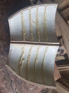

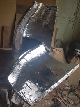

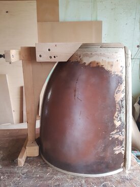

And I am approaching to the measurement of the internal volume:

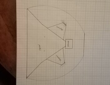

I love your speakers so much that I am going to try curved sides on my DIY Synergy horn build. Would it work out for me to back cut the MDF to get the curve or should I use bendable plywood with the finish being veneer either way? This is just a rough draft as I need to get the horn made first then I will know how much the curve will be... I am assuming I can make it much gentler.The horn will be around 31" wide and 27" deep, and 27" high. Any advice would be appreciated.
Everything I see is very nice, but if you bend the shape the way I see it on the millimeter paper/ see the top and bottom halves/, you better not do it, excuse me!
Joro
PS
If possible, post a some photos - about the real situation of your speakers.

I will post up some pics of the horn assembly as soon as I get the horn part.
