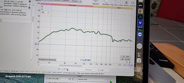

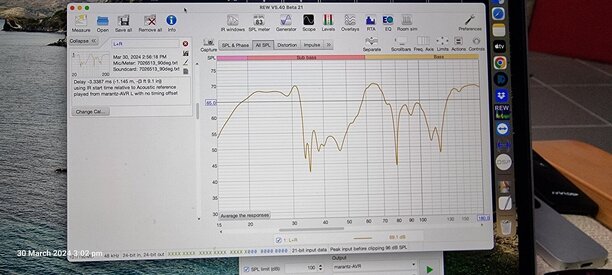

Will, did another fresh calibration using the Audyssey app, and after using the Audyssey One to do it's magic, uploaded it to my receiver, Marantz cinema 50, had a listen but didn't sound that good, everyone seems to say that it's night and day difference, I must be the odd one out, checked out with REW, and it was terrible, played around with the miniDSP, adjusted the subs, and that made much better, not perfect, but better, the first pic, is just out of Audyssey One, the other after miniDSP, did I do something wrong? I was expecting it to be amazed like some others have been, I've followed all the instructions, as to not miss anything, anyone has any ideas?

I see there is not much action on this thread here. I guess most people here are very advance and probably dont need Audyssey one anyway I am uploading this file to see if someones comments or help me improve things. This are measurements I made of my subs after Audyssey onne calibration. Any idea why the big dip around 50hz and the even bigger one at 82hz or how to fix it
  • two subs after Audyssey one.mdat

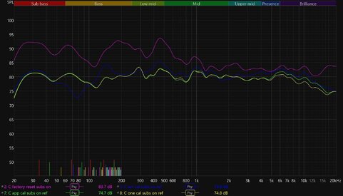

I did some tests on the central channel. UMIK-1 in the MLP without calibration file
scenarios ( all with subs on and reference curve in all cases):
1. factory reset -> looks bad
2. calibration run from the avr menu -> does some leveling
3. audyssey app -> makes it better
4. audyssey app plus one audyssey (V1.0) -> some differences in mid and high frequencies
I would say for my speaker there is not much difference between 3 and 4 except option 4 should set delays using the correct speed of sound.
I can test more combinations.

They are very narrow. You can ignore them. Most likely this is a room. You will not greatly change the decor in the room due to minor circumstances.
thank you. I was worried because they look so big, but like you say they are very narrow. How about the rest of the chart? how does it look to you?
sm52
Mar 14, 2019
1,018
If the crossover frequency between the main speakers and the sub is 80 hertz, then it should be normal. The peak at 35 Hz is +5 dB and may stand out. If the room is large, this may be acceptable. If it's small, there will be discomfort. It is important how the main speakers and subs are connected after setting the distances in the AVR. Are there any subtractions or large peaks near the cutoff frequency.
