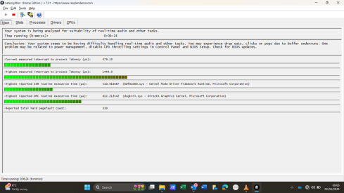

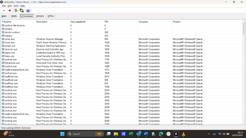

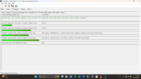

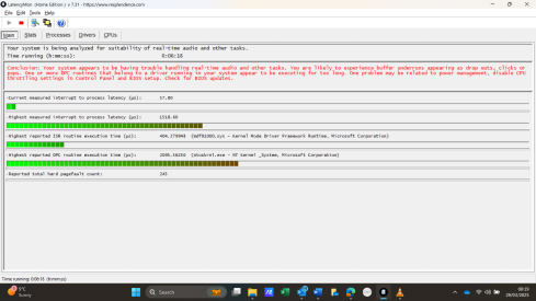

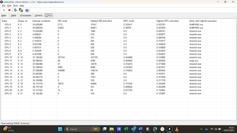

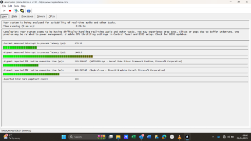

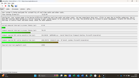

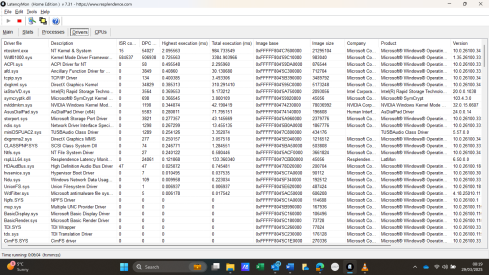

It seems to me from latencymon reports that the NT Kernel activity causes interruptions.
I wonder if i can separate the paths/activity - NB, i don't know what i am doing, but attach the reports that gives this clue. if i were to set the affinity for all audio matters to a CPU area unused by the high activity?
Here attached todays latency reports with PC plugged in and WIFI off, which gives best results so far, and all settings optimised.
