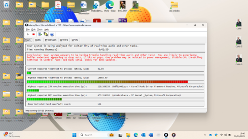

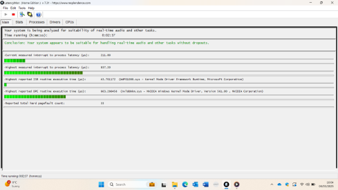

i surprised myself and ran the latencyMon tool successfully, twice. First time it quite quickly decided the system was inadequate and recommended a solution which i googled on and disabled the power saving throttling mode in control panel, it ran a bit longer second time which is the screenshot attached. I tried some REW measurements for intersest and found half of them would run woithout warning boxes, not great but perhaps an improvement. Nevertheless i am now stumped again as i am not sure about disabling throttling in BIOS successfully.........

Hesitant to be overoptimistic, i think things have improved, my computer supporter found and suggested as follows;
Download PowerSettingsExplorer from here and run it as administrator. Then find the following 2 options: Processor Idle Demote Threshold and Processor Idle Promote Threshold, UNtick them both, then go to your power plan settings, find the new option under "Processor Power Management" and set both to 100%. That helps lower mostly all latencies, if you are happy, you can stop here, if you want to try and lower them even further, please continue.
I now have a useable system, I got 12 minutes playtime below 1ms with WIFI on and 15 minutes (at least) with WIFI off.

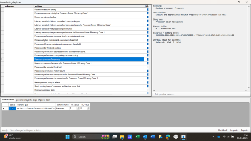

Where would i disable frequency switching?
The only referenece i can find is highlighted in the attached SS
The issue I was talking about was handled in linux - setting the cpufreq governor to "performance" (i.e. running at fixed maximum frequency), and setting the max frequency to something small. No idea if windows allow that. If yes, then likely in the Power Plan configuration.

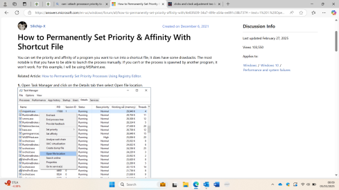

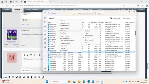

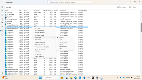

At one time i set the priority of the driver to high, and it seemed to be of benefit, but miniDSP say this is only the control panel, but i will try that again alongside the other changes that have got me to a half decent place now.

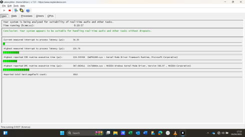

I thought i would try and minimise all opoerations, so turned off everything i thought i could in BIOS, that was;
LAN
Wireless/Bluetooth
Card reader
HD audio
Camera
and it looked really good for about 10 minutes, see first screen shot, all exceptions much lower than before.
then it gave up again, see second screen shot
Trouble is i cannot interpret from that what changed and i dont really wish to operate the computer that way either...........
