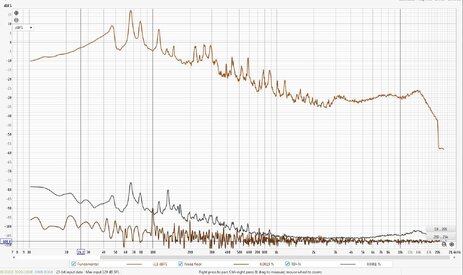

Looks pretty typical. Noise floor seems a little high. Here's an old, 16-bit interface tested using an analog loopback with a 20 s segment of "Closer" (Kings of Leon):

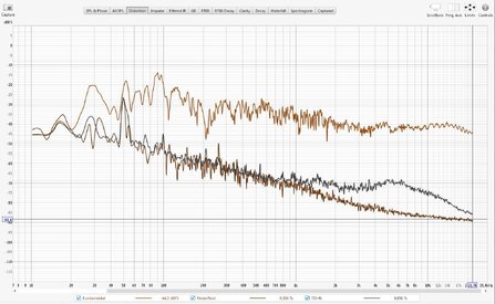

Looking at my and your measurements. Your signal level is 30 dB higher and the distortion level is 20 dB lower. You have a horizontal line of noise and distortion levels, and I have an inclined line. Is it because you have white noise and I have pink noise?
My measurement was with a music file. The noise floor shape difference is because I measured a loopback connection on a soundcard, not a loudspeaker. The soundcard has a flat noise spectrum. Electret mics have a noise spectrum that rises below about 8 kHz, room noise also rises at lower frequencies.

Then it turns out that when using a loopback on a sound card, the distortion is much less. Although objectively they cannot be more or less on the same equipment and in the same room on the same music track. Ok. I'll try it myself.
I think you misunderstand. Those are measurements of the loopback, not measurements of equipment.

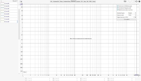

I have 7 measurements. When I go to the overlays window for the first time after measurements, there are no distortion graphs. Until I click on any measurement on the left.

Then my levels are normal.
