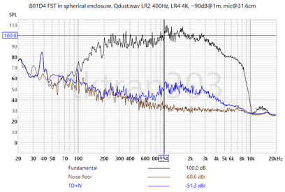

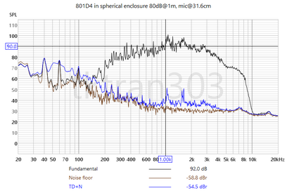

Yes, it's a puzzle to me as well. In fact, when I first sent these to @FSAF with +36dB gain applied, there was so much noise, we could not reconcile what the problem was.
Another session testing, this time at day break.
This time Sweep 1M samples, no repetitions, no SPL normalization for mic distance.
vs Pink Noise, various IR lengths, various mic selector

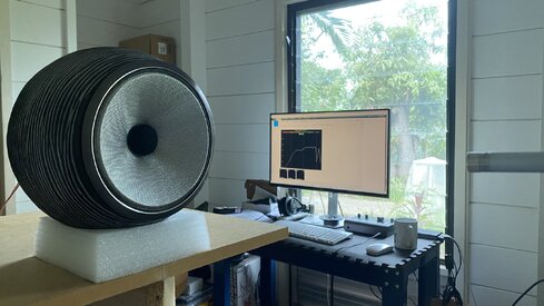

This is the midrange from the B&W 801D4 (2022 release)

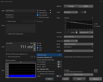

Thanks John for the software update to Beta 61:
This is another session with the new update.
Again 83dB@1m (ref. to 1KHz). This time I didn't bother to normalize to 1 metre- the SPL is absolute.
All recordings in this post were from the same session.

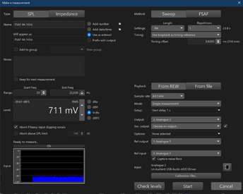

I have attached .MDAT to see if it helps us understand what is going on:

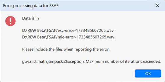

Here is a message I receive when I increase IR length to 900ms (or anything larger)
Here's the a full range Sweep using 1M samples. No repetitions.
Measure & preference settings:
The system being measured rolls off sharply below 200 Hz, its impulse response reaches the noise floor after about 250ms. Asking the processing to generate a much longer impulse response than the system has can lead to numerical ill-conditioning which in turn can lead to the Singular Value Decomposition function giving up, which produces that error.
I'm not sure what you mean by "understand what is going on". The measurements look fine to me. 100ms and 250ms are too short to capture the whole impulse response, but after that the TD+N is basically in the noise floor. That is as expected since the sweep measurement shows the distortion contributions are below the room's noise floor.

I think the question is simply why the noise floor SPL is rather high at 50dBSPL, a quiet room would expect background noise in the 20-30dB range assuming the SPL is calibrated. Tikkidy certainly is not measuring with poor performing equipment, Audient ID24 and B&K mic.
For example my own measurements show noise floor steadily decreasing towards 20dBSPL in the top octave. Different equipment obviously but this is an SPL calibrated result. But, I am not certain the "problem" is specific to FSAF, as @Tikkidy is also showing a nose floor in ESS measurement of ~20dBSPL, where I am achieving below 0dBSPL. Difference between ESS and FSAF noise floor is similar on my end, so I believe the problem is simply a high measurement noise floor or SPL calibration is off by an order of 20-30dB. Perhaps the problem is simply the mic input gain is set abnormally low?

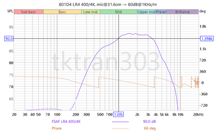

Now sir, would you like to have another listen to the B&W 801 D4 midrange with some music?
Or with filters applied Eg. LR4 400Hz/4KHz?
And at what SPL (equivalent) shall I set it on. 80dB@1m, with +36dB gain applied, (like your previous tracks with the SB12PFC)
Or some other 'standard' eg. 85dB@1KHz/1m:
or 90dB@1Khz/1m:

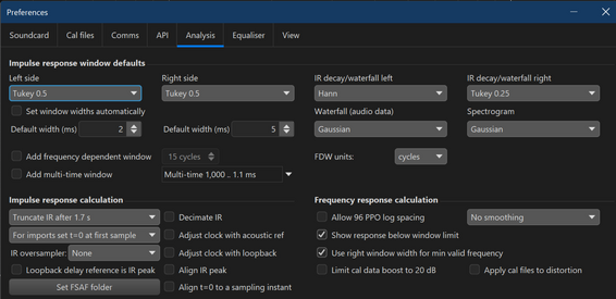

It would be great if there was an easy way to bundle up an mdat file and the associated FSAF WAV files for the measurements contained in the .mdat. At some point I'm going to want to clean out the FSAF folder, but I definitely want to keep the residual files for certain measurements.
I think an easy solution for this would be via use of the "Set FSAF folder" button. Currently it asks if I want to move all previous FSAF residual files to the new folder location. If it included an option to move only the residual files for the loaded measurements would be perfect to help me organize the files.
Even better would be to allow setting a relative FSAF folder path, like ./FSAF so REW creates a sub-folder in the same directory as the MDAT file and locates all FSAF residual files there. This would make it a lot easier to keep the file system clean, remove old unwanted measurements and keep the ones you do. Saving relative folder path within the MDAT file would make it easy to send measurements with residuals to others in a ZIP, that could be extracted anywhere and played back via the "Play FSAF residual" button without manual process of copying residual files to the specific FSAF folder configured in REW.
Just some food for thought as I'm nearing 1GB of residual files, but only want to keep 10% of them. It's quite tedious to pull the files I want to keep out of the FSAF folder for a given MDAT file since the file names are encoded.
Perhaps a prompt when removing an FSAF measurement from REW to optionally delete it's residual files could help as well.

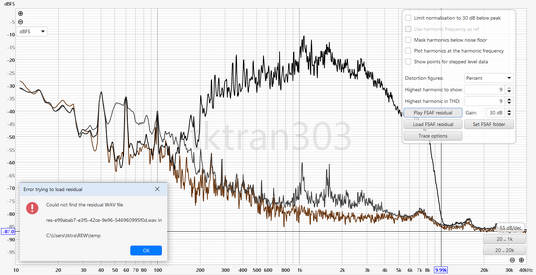

I believe @FSAF believes that one of the purposes of FSAF is in the listening of the residuals. Currently when a file is saved, it doesn't save the residual in the .MDAT.
I second the idea to save it with the .MDAT. At the moment I save all my file to the cloud/network attached storage so I may access them on another machine that is not in the test-taking machine.
b) GB have never been more affordable. If people have limited with storage, perhaps the /temp folder could be specified, instead of having on the default boot drive...
Right now it breaks whenever I try to access it eg.

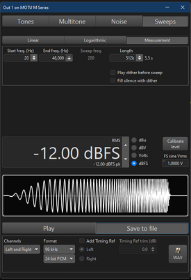

@dcibel

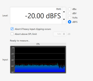

Should we be saving a Measurement sweep at -12dBFS?
When we make a FSAF measurement with that sweep, would it go through another pre-gain stage? Suppose that I've have my system calibration such that -20dBFS gives me 2.83V at the speaker terminals...
Compare your headroom on your input meter... I think this is the reason why the noise floor is different between Sweep and FSAF measurements...

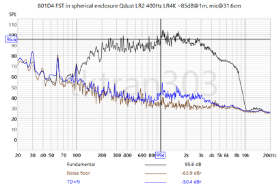

Whether I use the measurement Sweep, or FSAF, using a file-saved ESS stimulus, or a FSAF with ESS stimulus, this time saved at +20dB louder than the previous setting- I get the same frequency response:
Looking at the noise floors shows something very different between the three:
If the boosted stimulus was actually LOUDER than the original, we'd expect more distortion. In this case, it is less TD+N.
My conclusion is that the level of the noise floor is affected the calculated TD+N. But all 3 recordings were done in the same session (after midnight :hush:
For those who like to see it in % (eg. ARTA, Steps)- the same graphs are presented below:
What's happening? Am I a Beta warrior or boo-boo maker?
