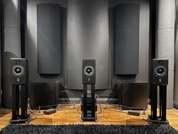

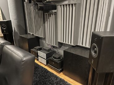

I have four HSU ULS-15s in a 24x15x8.5 room, controlled by a Trinnov Altitude 32. They're in 1/4 and 3/4 positions on the front and back walls, making them a bit of a work in progress using Trinnov's recent WaveForming algorithm. The "work in progress" part is trying to get both the time-related bass decay consistently under control from 20 to 120 Hz and the RT60 at the same time, which is the ultimate payoff from their technology.
Hi Stuart... I'm curious... what level of decay would you consider to be acceptable?

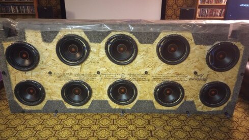

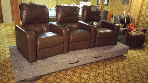

I run 2 Sterio Integrity 24 inch subs up front far field, 2 Dayton Ultimax 15 inch subs as near field, 9 JBL 12 inch drivers in a Hovereze platform. The Hovereze is for tactical response. It operates down to 1 hz and I cross it over at 65 hz.
