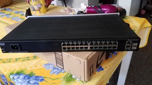

A few mods to my old Cisco switch... we moved the power to the same side as the lan ports, painted the case, rerouted the ground, and installed an aluminum front panel.
