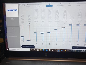

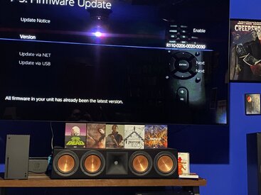

Received a new firmware update. Individual sliders are now fixed on the Dirac app

My first time using dirac. Were the sliders adjustable before that update? I updated my Integra on initial setup to that version.
