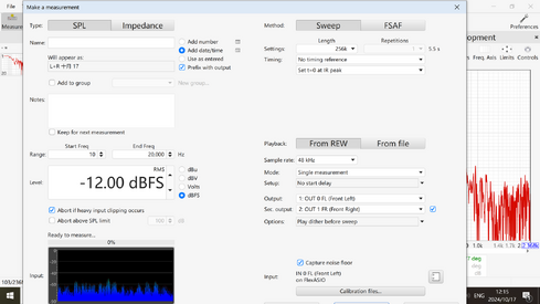

I tried to do a simple measurement on REW's latest version and I got a NPE.
Looking at the stack trace that's a very strange error to encounter. How was the Measure dialog configured? Probably easiest to attach a screenshot.
This is what the measure dialog looks like. However, when I just tried in the latest beta 57, the NPE isn't there.
It was an IllegalAccessError rather than an NPE, though I don't know how it could have been triggered. Nonetheless I did make a change in beta 57 to try and mitigate a possible cause, perhaps that has been successful.
