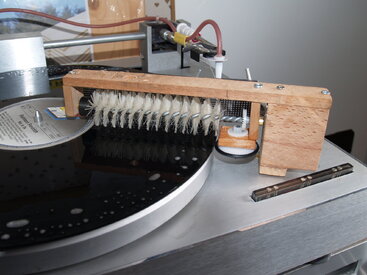

koeniwo
Apr 18, 2018
I use a DIY vinyl-cleaning-machine

KirmussAudio KA-RC-1 alongside a VPI-16.5 that I've had since the dawn of time.
