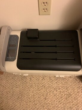

After inheriting a lot of "vintage" records (fifties and sixties classical music) with dust all over every groove joining my jazz and pop LP collection, I bought a ultrasonic record cleaning machine. See attached picture. Cleaning fluid is from the same manufacturer (1 bottle~100 LP`s). Not cheap, but efficient!
sorry for the double picture upload! It`s my first post on a website! absolute newbie

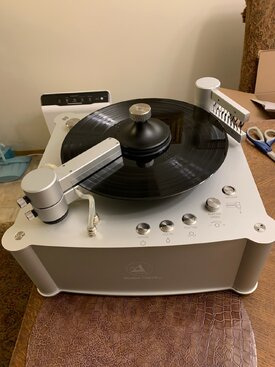

I've gone from kitchen sink cleaning with a brush to an Okki Nokki to a 3 lp slot Kirmuss and Clearaudio Dbl Matrix SE vacuum for rinsing & drying. I mix my own ultrasonic cleaning solution and just distilled water for rinse. I can do about 20 lps hr and it does a wonderful job.
Do you do the full Kirmiss routine on every record?

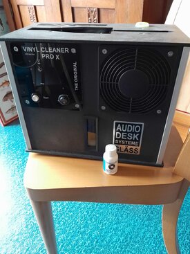

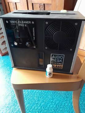

My Audio Desk Systeme does a fantastic on records old and new, plus new inner sleeves post cleaning
