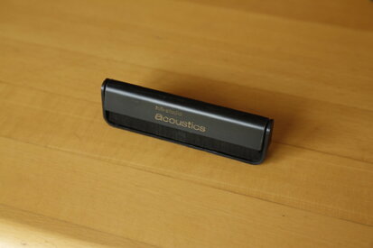

I use a simple carbon fibre handbrush _80A2102.JPG , some years ago I have washed the vinyls (collected since the early seventies) with 5% isopropanol in water with ~ 50yl Tween 20, then airdried.
