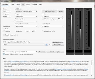

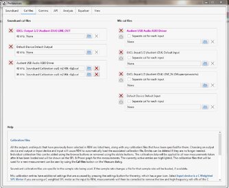

In the soundcard window I selected java drivers. There is no soundcard calibration file for this case. Then I select the ASIO driver, for which there is a soundcard calibration file. But REW does not automatically select it, leaving the previous selection.

I didn't think about it. But, if there is a soundcard calibration file for the ASIO driver, and I selected the ASIO driver, then the calibration file should appear in its place in the soundcard window for possible use.
Yeah, REW cannot know the two devices named differently, accessed through different backends, are in fact one.

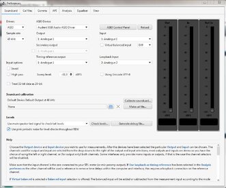

I closed REW. Opened it again. Java drivers are selected by default. The output device is also selected by default. Then I switch the driver to ASIO, these are different devices, but REW does not notice this. Leaving the soundcard calibration file selection field blank. This is the answer for Pavel.
Thanks, John has already lightning-fast fixed that. These bugs are extremely easy to make, the lovely joys of GUI programming...
